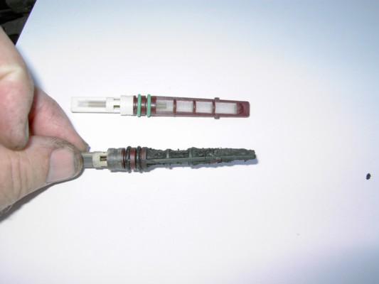

Attached is a picture of my orifice that caused me to replace the condensor, compressor and refrigerant lines.
Mines the bottom one. I backflushed the evaporator with alcohol four times, there was a bunch of green/yellow stuff (dye?) that came out.
As I undertsand it the orifice is not only a filter, but it is the mechanical point where the liquid is physically changed to a vapor and then sucking up the heat as it expands in the evaporator. I've got a writeup somewhere that I'll post sometime.
If I understand you correctly you are saying the orifice size for the R12 and R134a is the same.
Thank you for the reply and interest.

I've converted my system from R12 to R134A, and it was the same part. There was no other reference in the parts book. I remember seeing your picture of the orifice tubes in another thread. It looks like you have a lot of debris in your system. I'm just thinking that you might have another clogged orifice tube that is causing your problems.

Could you upload that picture of the orifice tube comparison to the photo gallery?

Done, it's in the general photo gallery.
