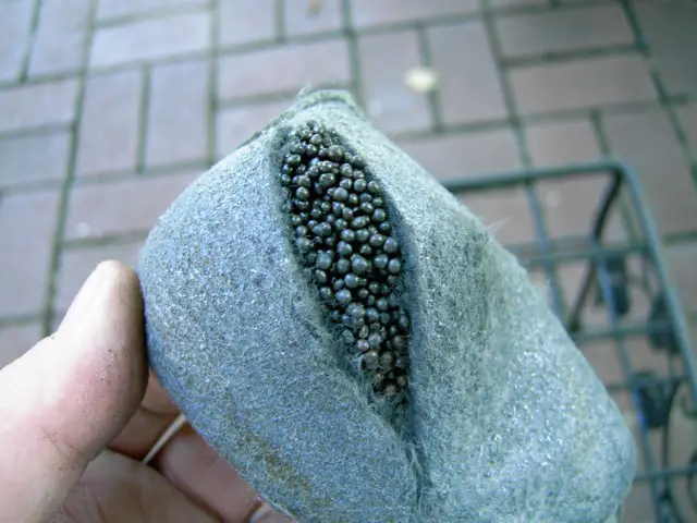

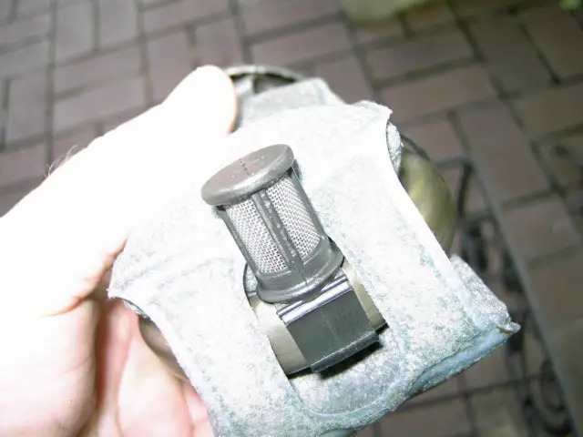

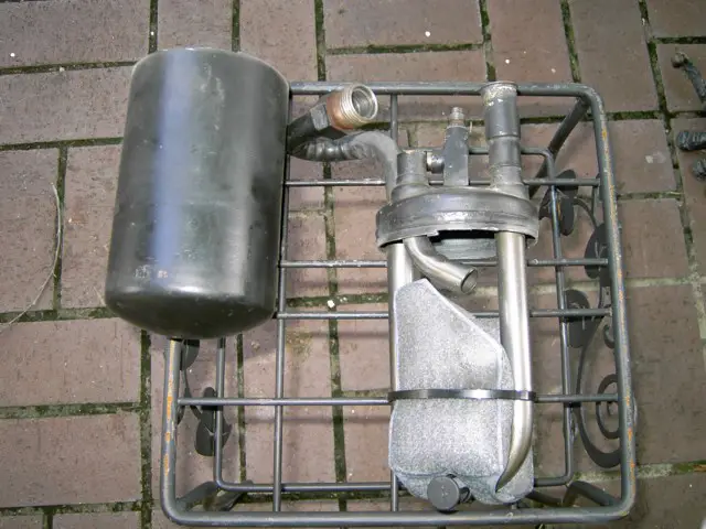

I cut open the accumulator that I removed last week. With luck I've figured out how to insert pictures.
Bottom off. The evaporator input line was cut off to make an adapter for flushing the evaporator. The bags with the plastic tie contain the drier material.
Bottom of output line showing drier bags and strainer
Drier material bag cut open. These bags were very tough and required several swipes with a box cutter

Wonderful! A great post. Thank you for sharing this....if you email me the pics I can do what is necessary to put them in your post. I have never glimpsed into one of these though I had heard what was in them, this is great. Thank you !
ps. the extra strainer makes clear why the evaporator rarely plugs up even in a granaded system.. the debris has to pass TWO filters before it guts to the EVAP inlet, which also has a filter !
