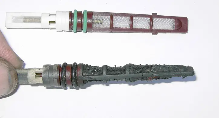

If your system is going to be completely evacuated (vacuumized), then this is a good time to replace the orifice tube. Those things do pick up a lot of stuff, and could get clogged. Take a look at Shamaal's orifice tubes in the picture below:

As for the orifice tube pic... WTF happened. I replaced mine when my A/C cruded out, but even at 130k+ miles it looked just like the new one I put in it. It did not look like that... Got the story behind that one, did the unit burn up at one point of time or something?

In the thread about that tube, it seemed like he had a lot of metal shavings clogging up the system. If you have a continuity tester, you could see if the pressure switch is making contact, or not.

It's actually a condition called "Black Death". If I understand it correctly, the teflon seals in certain models of compressor break down, melt and flow through the system. No metal shavings involved. When this happens the gunk gets caught in the condensor also and because it solidifies at ambient temperature cannot be flushed out. If you poke around some of the A/C component sites, they will void their warranty if a compressor/accumulator is replaced and the condensor isn't when black death occurs.

I changed the compressor because the compressor had a slow leak leak, evidenced by an oil spray line under the hood. I got a kit, that consisted of the compressor, accumulator and orifice. The orifice results you can see above. I read in several places thet when tis occurs the condesor has to be replaced. If you look closely at the picture there is no evidence that the crud made it through the orifice into the output screen so I assumed the evaporator was fine. I also changed the hoses because there was a gash in the suction side and I did not know the muffler was hollow. The only thing not changed was the evaporator and the orifice line.
