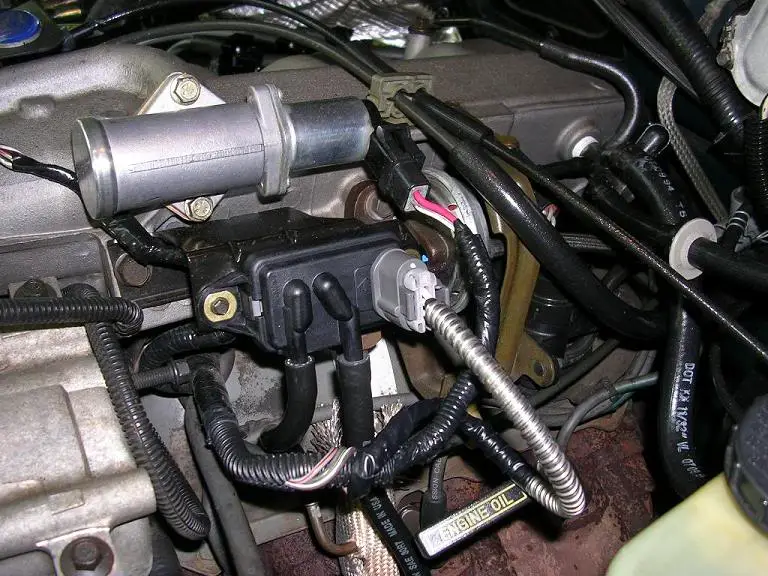

the egr valve is right behind the red and white wires you see going to the iac
i do not have one.....i took it autozone right after this thread and they couldnt find it either....the pic you posted , my engine manifold doesnt have that at all on the side..i dont know if they forgot at the factory
the guys at autozone couldnt belive it...one guy was cursing because he couldnt find it.....and that wire box you have under the iac valve, i dont have that either
