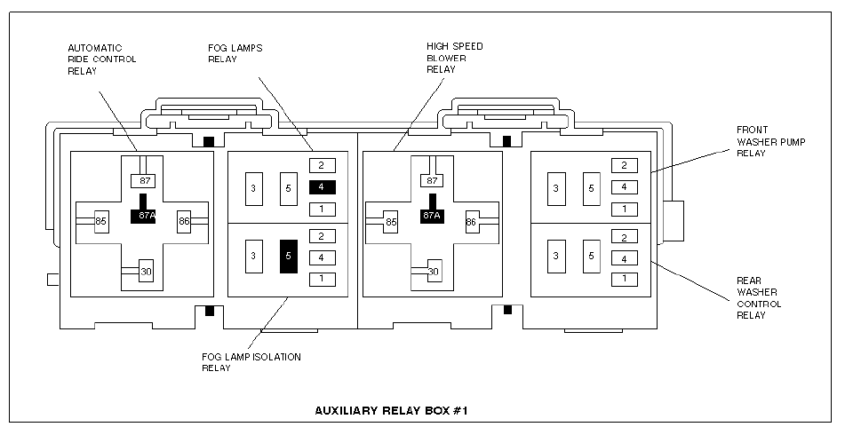

The first problem was the Fan High-Speed relay wasn't working.
Now, the resistor is also blown, so no fan action at all.
Do you know where in the relay box this is? Or a ford Part Number? Thanks for the help.
The High Speed Relay is located in the Auxiliary Relay box, near the air filter box.
The blower motor resistor is mounted on the air plenum, under the hood between the blower motor and the evaporator case. You might need to move the cruise control solenoid to get to it.
You should be able to get the relay at any parts store. The blower resistor is a special part you will need to get from the dealer. When you go, make sure they ask you if you have the manual A/C controls (3 knobs) or digital A/C controls (EATC) as the parts are different.

The relay for the blower is in the Auxiliary Box 1. Only the Battery Junction Box is diagrammed in the Owner's Manual. I think there's somewhere near 3 or 4 Auxiliary boxes, depending on the features you have.
Which relay did you replace?
I replaced relay #9 in the power distribution box on the right side of the engine bay next to the battery. I wasnt aware there are other boxes. Where are they, and which relays should I replace? Thanks again for the help.
Is it under the airbox? Ill try to get a picture of what I think it is tomorrow.
I replaced the relay in the junction box under the air filter. Still no air from front vents or defroster on any fan speed or ac setting. Any other ideas? Thanks again.
