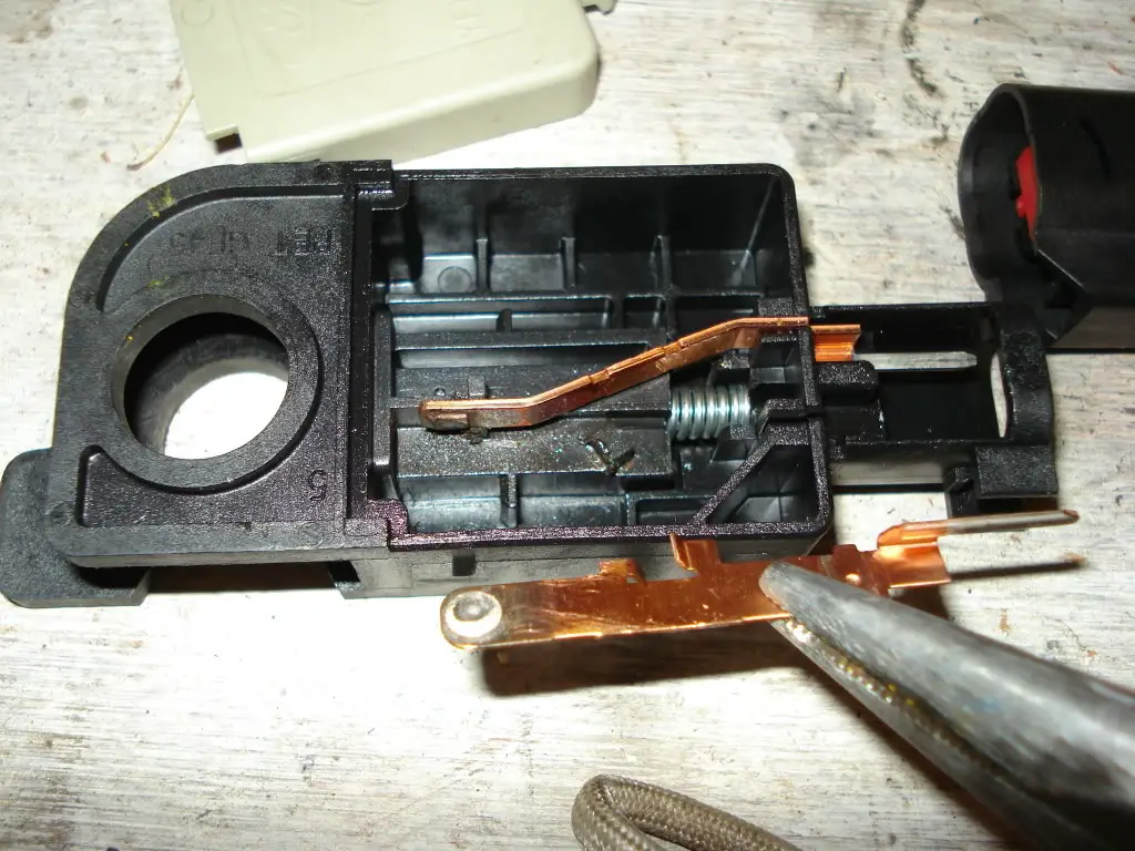

Yep, those terminals were definitely corroded by years of electrical arcs. The contacts are super easy to pull from the switch for a good sanding and a drop of oil on the micro slide. Seems as thought the interlock was still hesitant to disengage. I was hearing the clicks of a relay but still couldn't get it out of park at first. I fanagled the switch with my foot and that always worked. After a few rounds of that all seems to have come back to life without any size 11 assistance :) . Hopefully the wear down and subsequent sanding hasn't made the contact gap too large. I'll see on the drive to work.

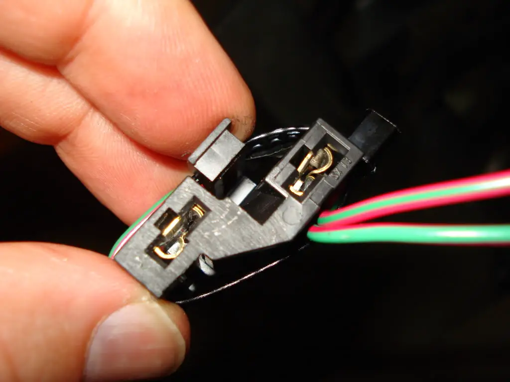

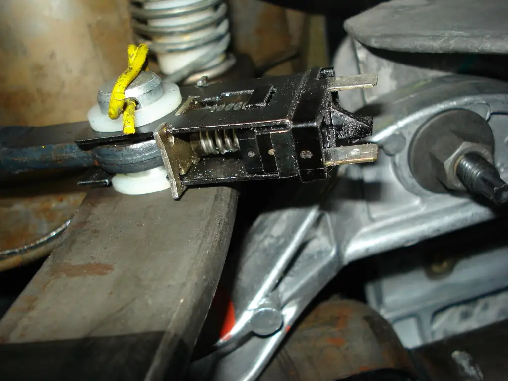

The maintenance on the switch is working. However, knowing that the contacts are now pretty thin, and upon further review of the mechanical/metal upgrade replacement part: Oreillyauto- BWD - Brake Light Switch Part # S37030, it looks as though, on a close up of the pic of the new electrical connector, that it would receive the OEM plug from the vehicle without having to splice in wiring. I might check it out. Looks like a dependable plug n' play upgrade for $15.

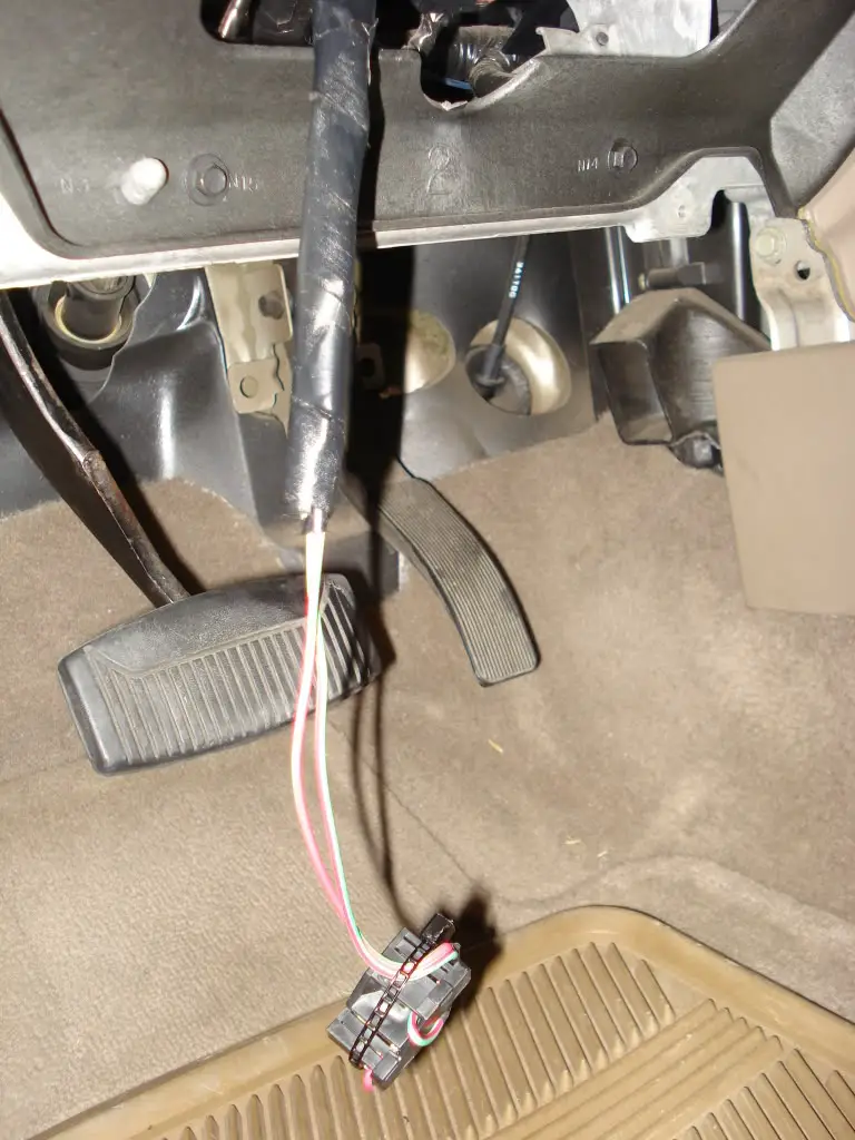

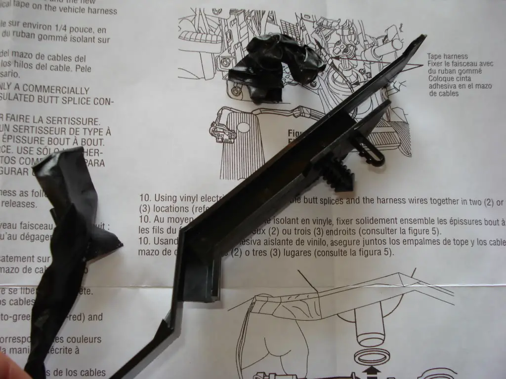

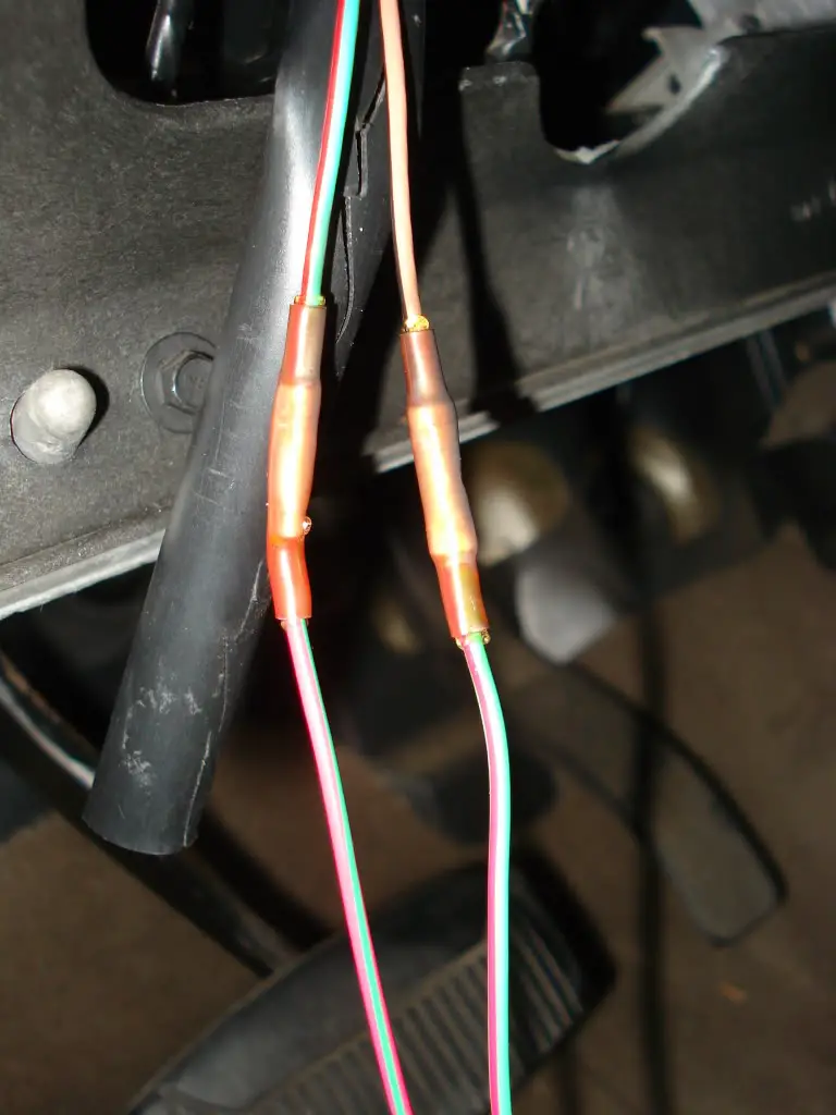

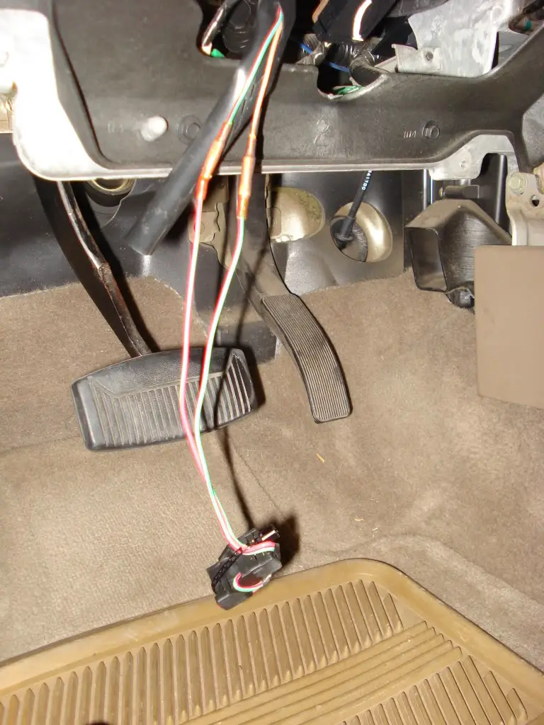

The BWD part is fantastic, and super easy to butt-splice in two wires. It comes with full instructions. The wires, on the new part, are ran through, and taped to a plastic bracket for some models; maybe models with the adjustable brake pedal. ? I just needed 6" of wire and no bracket upgrade, so cut it off. This leaves just the new connector and 6" of wire. Cut off the old connector at about 3", and spiced in the new. Slapped on the new METAL switch, which comes with 2 external plastic bushing/washers AND a new black one to replace the old one. Nice, tight design..no sloppy play.
Remove the switch assembly and then cut through all the electrical tape that holds the 2 wires under the steering column. Free it up enough so you have a bunch of slack. Re-route the 2 wires separately from the column harness wires and this will create more slack in the connector wires. Now reconnect to the brake light switch and mount it back on the brake pedal and you won't have anymore intermittent brake light problems.

No, the Windstar part was a direct plug and play replacement. I have noticed in the last couple weeks my brake lights stay on after the pedal is released. I'm not sure if it has to do with the spring inside the switch or if the updated Explorer part is a little more robust.

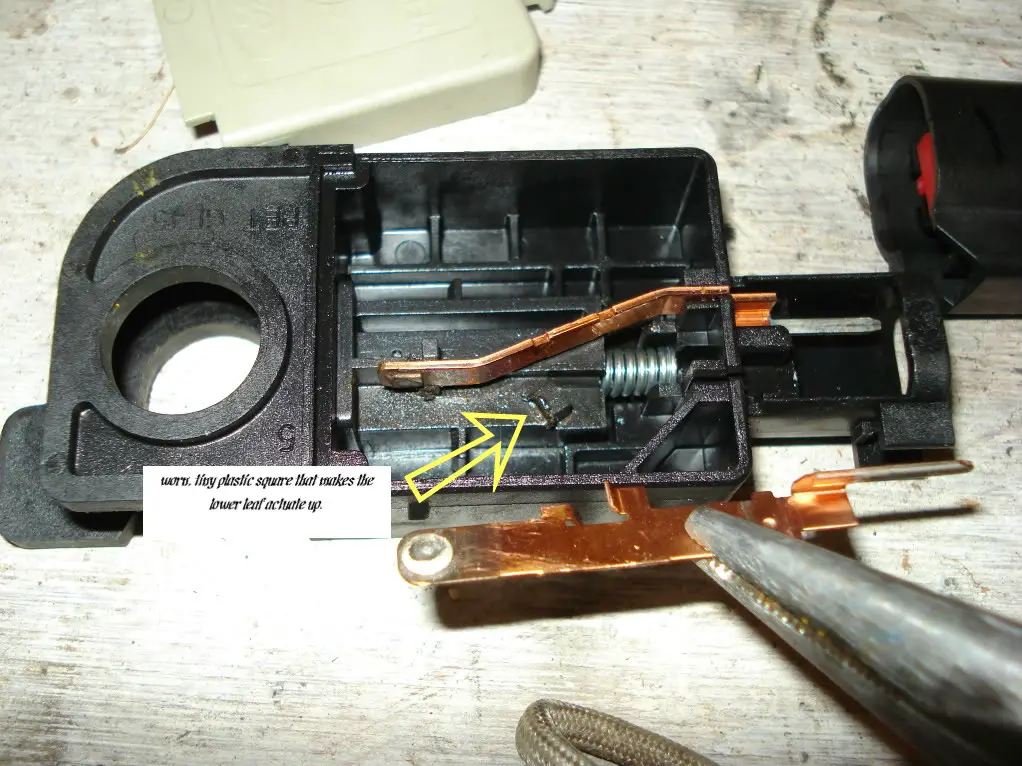

Replaced it not too long ago with the windstar one, bit the dust again. I took the original one apart and I can't believe how flimsy this thing is, anyway, one of the metal plates was bent so no point even filing it because as soon as I took it out, it came apart. So, time to get a new one or hoping I can take the metal plate out of the other one and between the two have a good part.

I have no brake lights on my Explorer. Have taken the switch off and sanded contacts per another post. Also lubed the plunger and verified functionality of switch when activated. Re-installed and still no brake lights. Verified bulbs are good. I will buy a new switch this week, but since this switch is mechanical in nature, I don't see the point since the one I have seems to work. Frustration reigns supreme! :exp:

And Finally....the dreaded "can't shift from park when engine is on".... everybody says the shifty/interlock solenoid! Because the brake lights worked the whole time the consensus was that solenoid. No deal there. but yes all the jostlin' did have it workin for a week or so and then again it starts jamming up. Hmmmm so I come across this thread? and Voila! I popped open our 2 pole switch-5 pins (brake lights) and (power to interlock solenoid) Seems the pair to the interlock was badly carboned over.. so a complete disassembly and individual clean and shine of each copper leg with 600 wet sand...BOOOM! she works better than ever now...Shifts out of park without a glitch. We'll keep an eye on that switch and start shopping ebay for a high quality replacement should it reoccur

Where does the black piece go? I don't see it in the pictures.

Hopefully this is correct. If so, my only question is where does the black plastic (bushing/washer?) that came with it go?
Thanks
The bushing/washer goes on the post on the brake pedal lever...don't try to install it on the new brake switch...fussed with it for 10 minutes because of that.

I'd rate this, on a 1-10 difficulty rating, at a 3. Pull the pin, old switch off and install new one. Splice and attach the two wires on the new switch to the old (red to red and green to green) and you're done.
