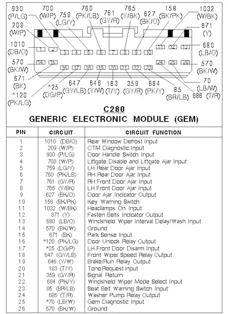

C280:
1, dk blu/org, defrost switch in
2, wht/ppl, ctm diagnostic in
3, ppl/lt grn, door handle switch in
4, wht/ppl, lift gate in
5, lt grn/yel, LR door ajar in
6, pnk/lt blu, RR door ajar in
7, gry/red, RF door ajar
8, yel/blk, LF door ajar
9, blk/org, door ajar ind cntl
10, blk/pnk, key in ign sw
11, wht/blk, park/headlamps on in
12, yel, fasten belt ind crtl
13, lt blu/org, interval/delay wash in
14, blk/wht, gnd
15, blk, park sense
16, pnk/lt grn, door unlock relay cntrl
17, dk grn/ppl, door disarm in
18, gry/lt blu, wiper speed crtl
19, yel/wht, brake/run relay crtl
20, tan/yel, sound tone in
21, gry/red, signal return
22, pnk/yel, wiper mode select sw
23, brn/lt blu, seat belt warn sw in
24, tan/red, wsher pump crtl
25, lt blu/wht, diagnostic in
26, blk/wht, gnd

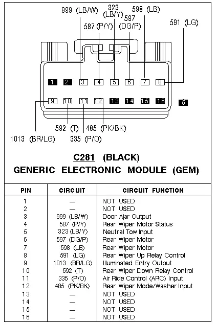

C281:
3, lt blu/wht, door ajar out
4, ppl/yel, rear wiper park sense
6, dk grn/ppl, rear wiper high sense
7, lt blu, rear wiper low sense
8, lt grn, rear wiper up relay
9, brn/lt grn, illuninated entry out
10, tan, rear wiper down relay cntrl
11, ppl/org, air ride control in
12, pnk/blk, rear wiper mode select in

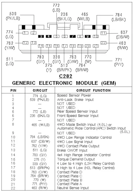

C282:
1, lt grn, speed sensor pwr
2, pnk/lt blu, anti-lock break in
3, pnk/lt grn, 4x2 cntr axle sol cntl
4, brn, 4x4 axle disconnect sw in
5, lt blu, rear speed sensor in
6, blk/lt grn, front speed sensor in
7, dk blu/yel, 4x4 center axle sol cntl
8, wht/lt blu, 4x4 mode sw in
10, lt blu/blk, 4x4 low range ind cntl
11, dk blu/wht, 4x4 low signal input
12, yel/wht, 4wd contact plate out
13, lt grn, brake on/of sw in
14, gry, 4x4 high range ind cntl
15, yel, torge-on-demand out
16, gry, 4-lo to 4-hi relay cntl
17, brn/pnk, 4-hi to 4-lo relay cntl
18, org/wht, contact plate D
19, brn/wht, contact plate C
20, wht, contact plate B
21, ppl/yel, contact plate A
22, red/wht, gnd (M/T), neutral sense in (A/T)

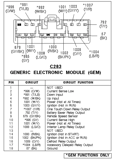

C283:
2, org/wht, current sense low
3, tan/lt blu, down in
4, wht/blk, up in
5, wht/yel, power-battery
6, gry/yel, ignition(run)
7, yel/red, one-touch down relay ctrl
8, tan/yel, battery saver relay ctrl
9, gry/blk, vehicle speed sensor in
10, gry, current sense high
11, wht/yel, power-battery
12, lt grn/org, interior lamp relay ctrl
14, red/blk, ignition (start)
15, blk/pnk, ignition (acc/run)
16, org/yel, defrost relay ctrl
17, lt blu/red, acc delay relay ctrl
18, blk, gnd
This is from the 97 manual:
I should have waited and saved myself a lot of typing. Thanks for posting the real thing for the right year dogfriend!
LOL Hey thanks alot! I appreciate the effort! And thanks for the diagram! Thats exactly what I'm looking for!
I'm glad you both posted this info just what I needed to see to cross reference the 96 GEM with the 97 GEM all seems to be the same except for the axle disconnect and the way the 4X4 functions. Now time to experiment with a 97 GEM in the 96 :)
