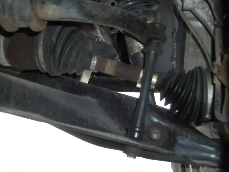

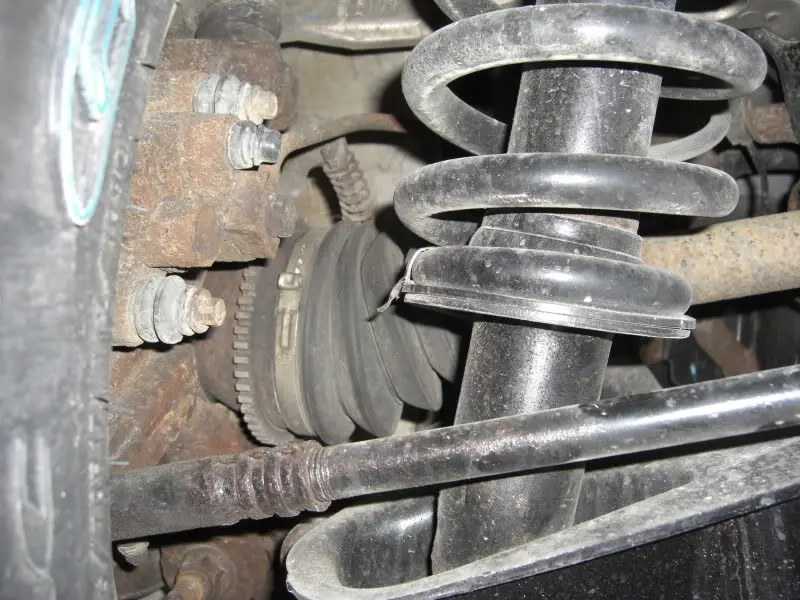

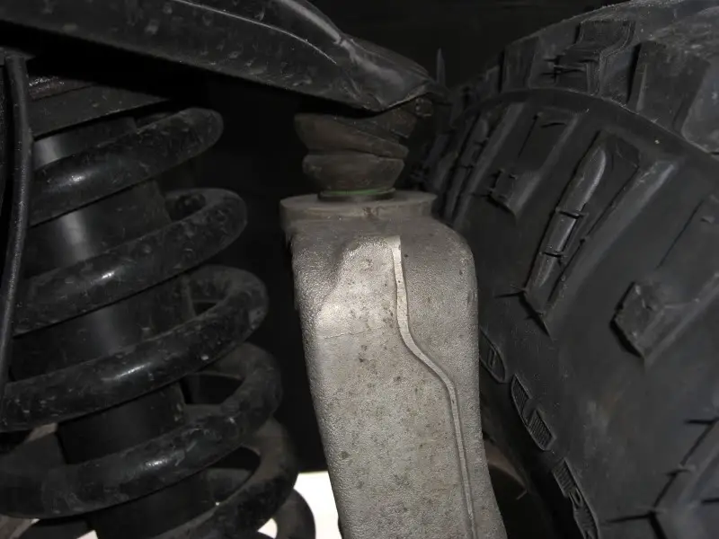

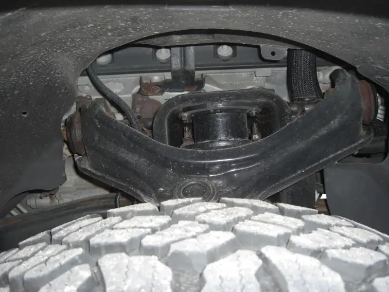

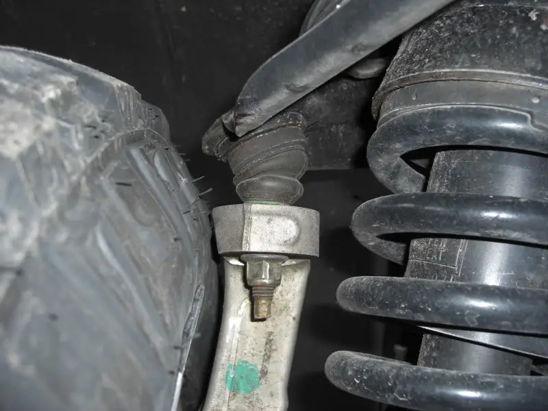

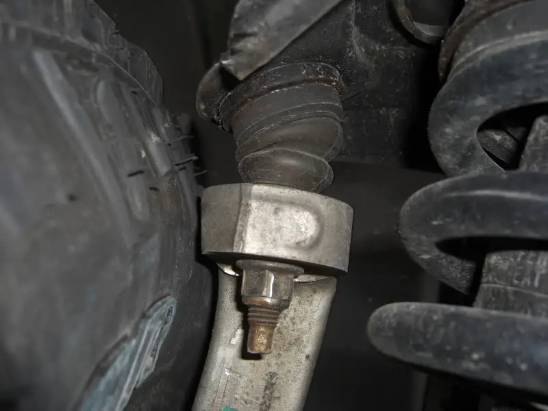

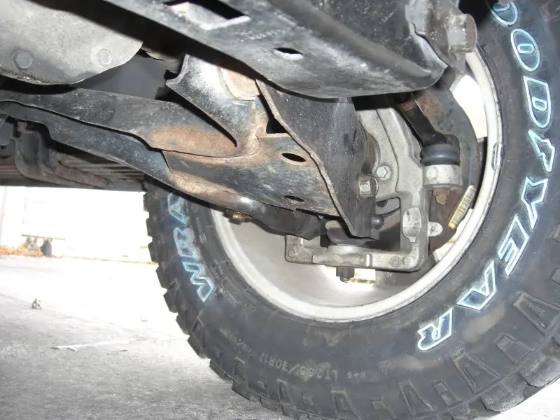

Well I decided to take a bunch of pictures for you guys of various suspension components to get an idea of what kind of angles and such we're dealing with, got some of the A Arm/Ball joint, front and rear CVs, tie rod end/lower ball joint, rear axles through the frame and such.
Personally to me I see no issues with the rear, and the front ball joint, yeah, I can see maybe if we're nailing large pot holes or doing extreme off roading, and have already worn out stock parts, then maybe. But to me, it doesn't look too harsh..I don't think it'll lead to an instant failure. I'll let you guys have a look and be the judge. New upper arms will definitely correct this angle, but I don't think its that nasty.
The ball joint with the black boot is a replacement A Arm, and the other is original to the truck. I see lots of clearance with the rear axles and everything else looks fine. I did notice however that these tires are awefully close to the hub assembly, hah.
Control Arm;
Ball Joint photos;
Front CV;

Front Lower Joint and Tie Rod End;
