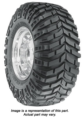

Old 03-17-2003, 12:18 AM   #20
eXplorerchic
Elite Explorer Babe
sXc Member
Decatur, AL
eXplorerchic's Avatar
2000 Sport
Join Date: Jul 2002
Posts: 1,076
Vehicle Specs
These Mickey Thompson Baja Claw...
