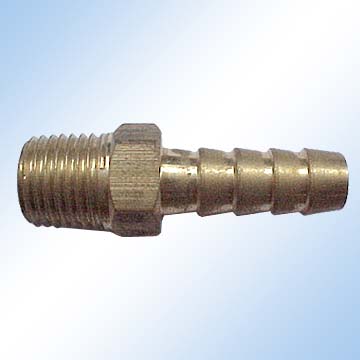

So does anyone know of a similar solution for the 2002+ "sealed" transmissions without a @#^%$ fill/dipstick tube?
Well, in some ways these transmissions are easier. You drain and fill rom he same plug. Plug has a tube that sets level. Basic procedure is drain, overill, warm up to proper temperature, drain out excess with engine running and perfectly level. It just requires some adaptors and a suitable pump. Beats dropping the pan!
I feel kind of guilty... I have that tool laying around and just cannot locate post move.... why guilty? because in reality all we all need is to know is the threads.... like is it 1/8" NPT or something, then we can improvise. I promise when I find it I will post what I find and a work around.
1/8 NPT is pretty small, I'm guessing either 1/4 or 3/8 NPT. You could use a barb fitting which are available at most hardware stores - for $2 or $3 you could pick up one of each.
