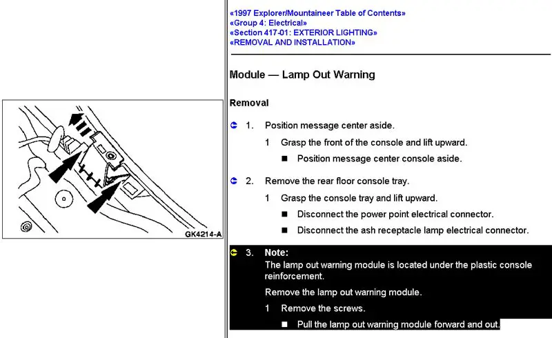

Where exactly is the lowm module.
So my low beams are still out.
Ok so I ruled out the fuses, the bulbs, and my light switch on the steering column. The only thing many people can come up with is the lowm . Where exactly is it under my message center? I'm taking my 95 ford explorer to the ford garage on the august 6th(thats the only time i could into the dealer). To run the diagnostics and figure out what they think is wrong will cost my $54.
I personally would prefer to buy the module save $54.00 and put that towards the module itself.
Also I can't find anything on it in my chiltons manual or cd.( yes i also read this in a few other posts.
Help would be greatly appreciated.
Thank You.

pg1
dogfriend is offline

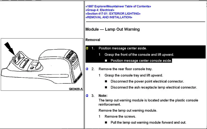

Old 07-30-2003, 11:54 PM   #5
dogfriend
Human-Animal Hybrid
Carmichael, CA
dogfriend's Avatar
'97 Sport 4x4
Join Date: Jul 2002
Posts: 8,828
Vehicle Specs
pg2

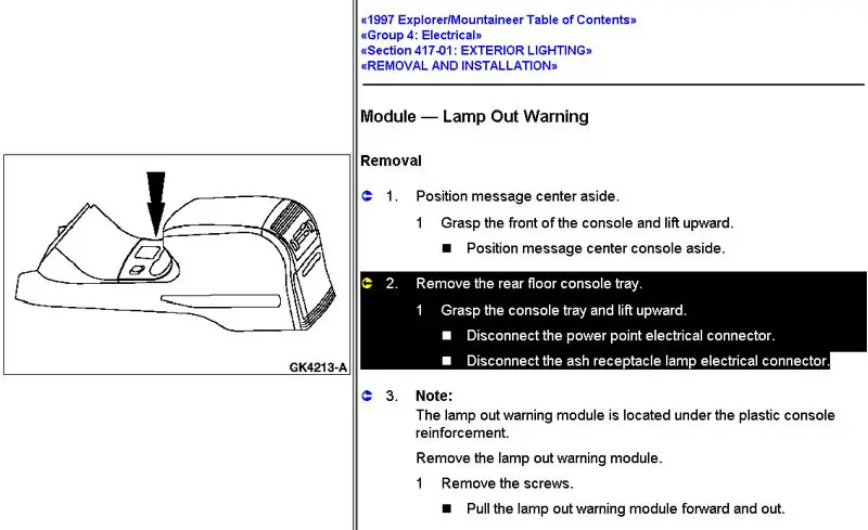

Old 07-30-2003, 11:55 PM   #6
dogfriend
Human-Animal Hybrid
Carmichael, CA
dogfriend's Avatar
'97 Sport 4x4
Join Date: Jul 2002
Posts: 8,828
Vehicle Specs
pg3

bingo! thank you thank you thank you dogfriend and all the others that helped. I just removed it, and popped the casing open, on the circuit board it was burn out im not sure what all the #s mean buts it on r 11 r 12. now i saved myself a trip to the ford garage...so how much does this thing run?

Usually on a printed circuit board, R11 and R12 would designate resistors. If they are color coded resistors you could find out what the values are from the color codes, most likely they are chip resistors and you can only tell the value from measuring with an ohmmeter or from a schematic (no board level schematic in the Service Manual).
If a trace on the printed circuit board is burnt, it may be possible to jumper around that part by soldering a wire around the burnt section.
I looked for a price at fordpartsnetwork.com, but didn't find anything. If you email sales@fordpartsnetwork.com , Torrie will usually email a reply within an hour or two. Just tell him what you are looking for, include the part number if you have it.
