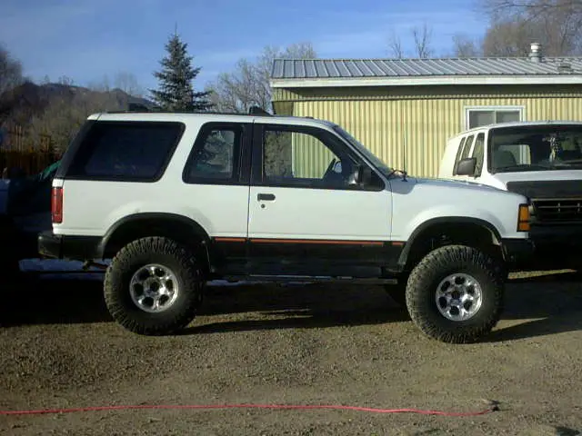

new pic. A few dents later ;)

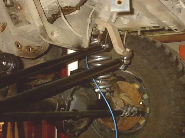

New SAS :)

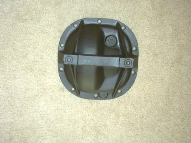

New toy :) DMS diff support/ cover

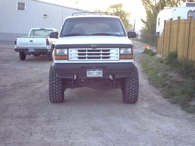

My new winch mount bumper
