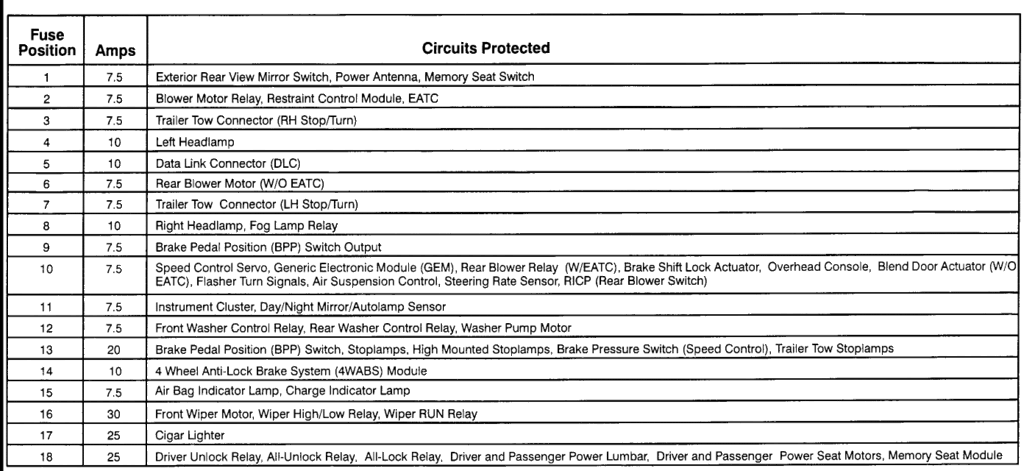

Check maxi fuse #4 in the battery distribution box and #26 in the fuse panel. These are for power windows. I'll post a diagram if I can find it.

Hopefully these will help.
