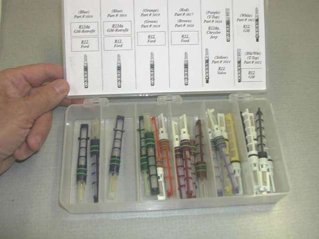

Now you'll have to do the conversion to Canadian $$. Let's assume your compressor is crumped. New compressor $250. easy DIY. SHOULD replace the accumulator. $60. I'll recommend you first remove and check the orifice tube, to see if your compressor died the "black death". (black crud and metal filings clogging the O-Tube screen - I'll post a pic of a new one in a min) If it did, you have a slight different problem on your hands. If not, make your replacements and then take it to the shop to evacuate and recharge with 134 and add PAG or Ester oil. So, if you want to know, my advice is open up and check the O-tube first.
O-tubes come in about or 6 main flavors...in an assotment they are really inexpensive...
A single one for the Ford looks like this.... see the screen ? Check to see if it has collected black stuff and/or metal shavings...

Thanks a million for the info and pictures. I'm ok with jobs but I don't know squat about A/C & can't afford to scrap it...(the truck)

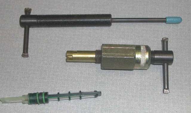

Good advice V8! Thanks. I'll post some pics of the tool
Ok... here is the main tool (center) a valve (bottom) and the when all else fails extraction part of the tool.. (top)....
With the system discharged and the orifice tube section apart, you slide the tool into the tube to capture the val;ve... they mate like so....
and then with a twist you hook the ears... like thus....
Often you can just pull it out, if not you can rotate the collar to make the tool an extractor. If you break the valve, you change to the top tool, which screws into the tube remains to pull it out.
