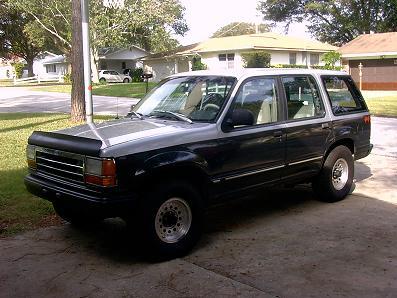

Here is what it looked like when i got it, these picture were takin the day after i got it after i had given it a good bath..... Sorry the pics suck but, yea, oh well...

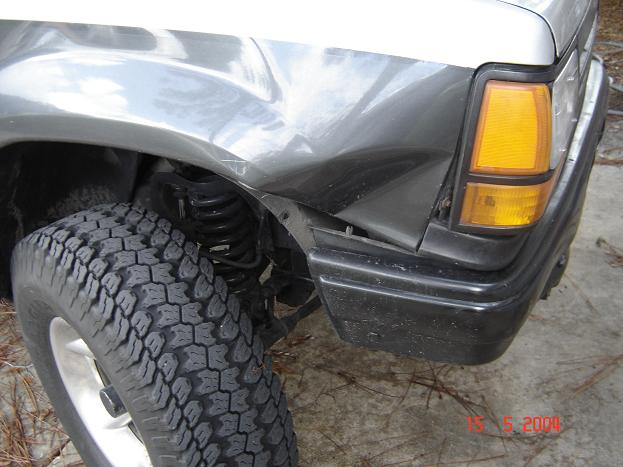

Damage caused when i rearend the Toyota:

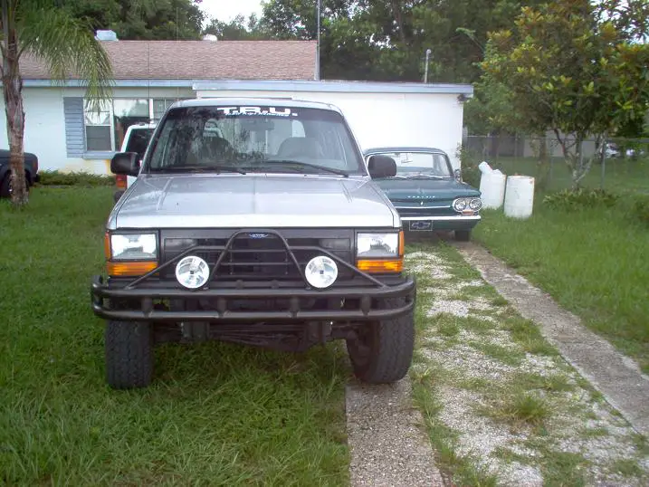

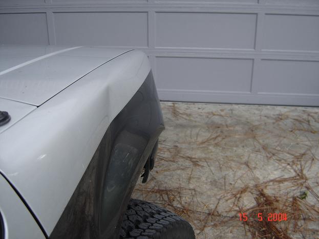

We pounded the fender out, since i will most liekly be recieving even more damage offroading, so whats the use in replacing it. I did build a tube Bumper for the front of my truck. Me and my brother built it outta 2" DOM Tubing and soem 1" DOM Tubing. THe two main bars are 2" and the Prerunner/light bar is 1".
I dotn have an pics of it yet due to my camera gettign stolen but here is the pounded out fender and some progress pics of the Bumper. Its done now but jsut not painted, ill try and borrow my bros Camera one day this week...
PS- Dont pick on the Chicken Sandwich Sticker, :p its Now gone only sported it for bout month, its my Nick name in the offroad club, but now its replaced with a T.R.U Offroad Sticker....

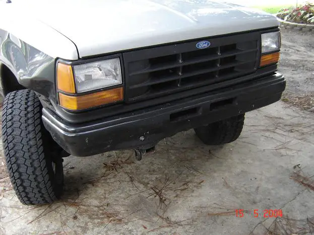

I wanted to remove the Trim on my truck, it was aprt of the De cgromign stage, well in the process it took soem paint with it... I already had paint below the trim chipping from rocks and other stuff, so i just decided to go ahead a herc it below the Trim line.....

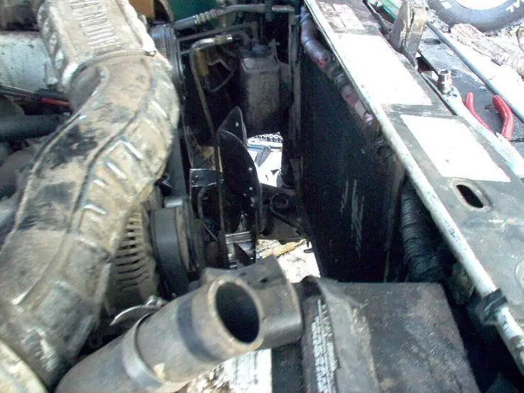

Been through 2 Radiators and 3 Fans on my Truck, I replaced the original becuase it was all cracked up and i didnt want a flan blading breakign off on me while traveling at 60mph.... So i put a Flex-A-Lite Flex Fan on. This required a Special Adapter, a 2" Spacer(recommended by Flex A Lite) and the Reverse Rotation Fan. Well that fan one day whel jsut out crusing on a clay back road and goig nover a bumper went through the Radiator, So on went a Non Flex A Lite Brand Flex fan, also got a 1.5" spacer to move it away from the Radiator some. Much better fit now. So on my First offroad trip with TRU Offroad(local 4x4 Club) I did good the whole day till we decide to fo play onlogn the edge of the lake. Well where we out there are lots of Air Boats launchign and what nots so lots of hidden holes in the water o nteh way out. I folled a Jeep on the way out, THe first thing i shoulda done was turn around when i seen it swallowed his 35" Tire, Note im on 31"s me being dumb follow him. Whew made it out there. On the way back in took same route this tiem fan acts up i dunnow why, bends the blades and into the radiator it goes. Thanks to the great guys in the club we patched up my Radiator with some Putty that turns into stuff liek steel it got me home and driving around that week.... I still carry that radiator and a the flex fan(bent it back out) incase i mess up this radiator or my electric fan goes out.
Last pic is the way we had to take on the way out to get to the edge of the lake, Not till we got done fixing my radiator did we notice the gate that led out to there.....
