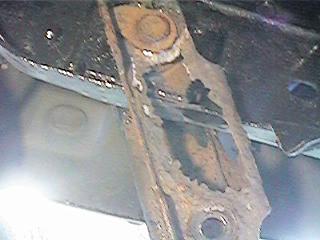

My Shackles were in this condition (before cutting anything)
I used a 4.5" cut off wheel to cut away the shackle and bolt head, but removing the bushing was still a PITA. You need to remove the bushing material before trying to press out anything. I used a combination of Drilling, scrapping, and burning (propane torch approach) as recommended by others having the same problem. if you try and press out the bushing without removing the bushing material then you will collapse the frame support like this because the Bushing material is bonded to the outer shell and Metal bolt sleeve.
Burning with the torch is no big deal. The material doesn't burn it kid of smolders. I expected the bushing to burn right up, but I had to burn it for 10 minutes then scrape away 1/4" of material and repeat the process.. Once the bushing material is out of the way/gone then you can press out the bolt sleeve. You must re-use the metal shell so take care and not damage it.
Man, that is one scary shackle!!
