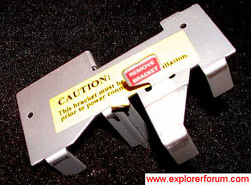

Ford CDX6 Radio (w/integral changer)
A Ford CDX6 radio would be a straight plug-in swap for your 2000 Explorer. Two important things, though - first, you need a "Premium Sound" version, NOT one from the Audiophile System (aka "Mach"). The "Mach" version has a "DSP" button (like your e-bay example), and will not sound right in your vehicle, assuming you do not presently have a "Mach" sound system. The radio for the Mach system sends all of the low frequencies to a separate, remote SW amp, without adding that, your radio will sound like it has no Bass (because all the bass is channeled to the SW line out).
The second thing is, if you get one of these radios used, you want to get one with the shipping bracket intact! If somebody ships it across country to you without the shipping bracket, the radio's CD mechanism will likely get damaged. Here's what the bracket looks like:
I have a CDX6 radio in my Mountaineer, along with the Mach Audio Sound System, and a console-mounted factory Ford CD changer. With this radio, you can have six discs in the radio, six more in the console changer, and be able to use all of your Steering Wheel Controls, Rear Seat Controls, etc., without adding a bunch of adapters and such. You can even play two discs at the same time (one through the speakers, the other through the rear seat headphone jacks - Ford calls it "Dual Playback" mode).

Thanks, that's what I wanted to know. Is there a part number I should be looking for?

CDX6 Premium Radios
The CDX6 Premium radios that would work in your application (Premium Sound W/O Audiophile, with Spring-clip mount) would include the following models:
1C3F-18C815-AB (originally for Ranger, Escape, and F250 truck)
2L3T-18C815-AA (originally for F-150 Series truck)
1S8F-18C815-AC (originally for Mercury Cougar)
Some of the radios that fit, but you should not use because they are meant for a Ford Audiophile system with a separate Subwoofer would be:
1L2F-18C815-LA/MA (Sport/Sport Trac)
2L2T-18C815-BB/HA (Explorer Sport)
YL2F-18C815-BE (Ford Escape)
3L2T-18C815-AD/BD/CD/DD (Explorer Sport and Sport Trac)
