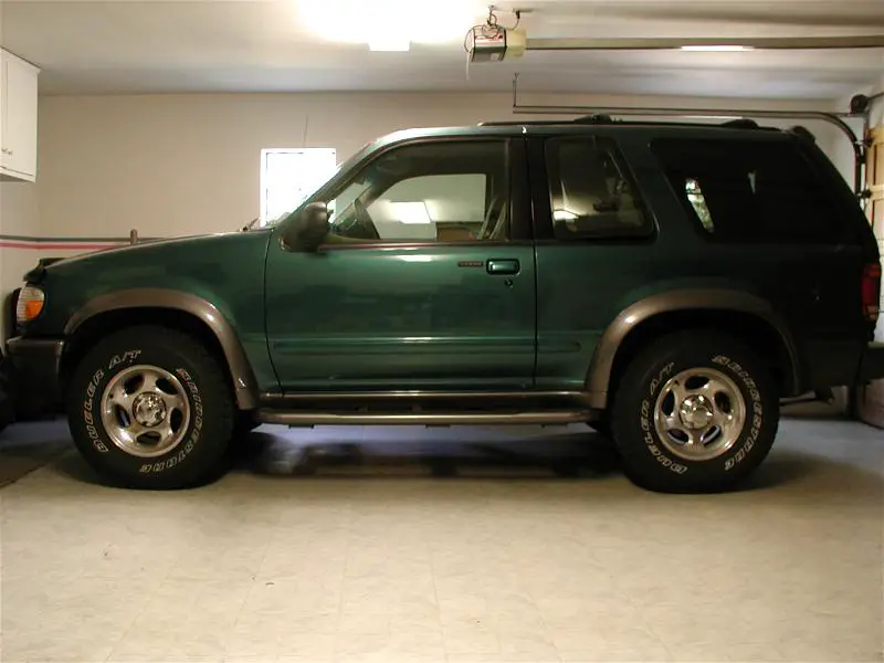

Bridgestone Dueler A/T Revo 31x10.5x15
Anyone have any photos of these tires on a 97 Explorer 2 door 4x4? And did you have to do any trimming? I'm wanting to see what they look like on the explorers.

I have 265/75/16s on my 98 Sport. They're only about 1/2" taller and the sidewalls are exactly the same.
They required about an inch of trimming in the front fenders (inside/back, plastic only). 31s should require a bit less trimming.

Quote:
Originally Posted by SubZeroZ28
Looks close. Does it rub any at all?
The complete answer is "yes, it can rub", but only when going steeply downhill with only one front wheel on the ground and turning in the direction of that wheel. In other words: only under extreme conditions I have no business getting into without lockers anyway .
It's really just the lighting in that pic. These both show the steering centered, but the gap isn't obvious until it's lit up:
On road there's almost two inches there even at 3/4 steering travel.

Quote:
Oh yeah I see it now, it was just the light. Those tires do look good on your X. Thanks for the photos
