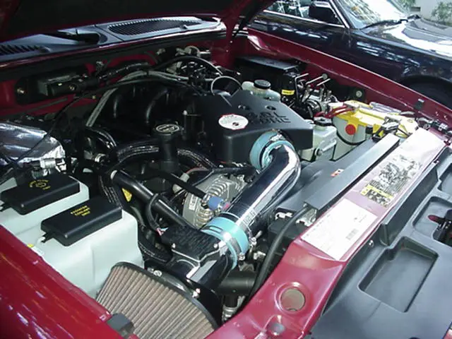

and spindle that looks super clean...then again its an 03 so you dont have far to go but ya kno w;)
