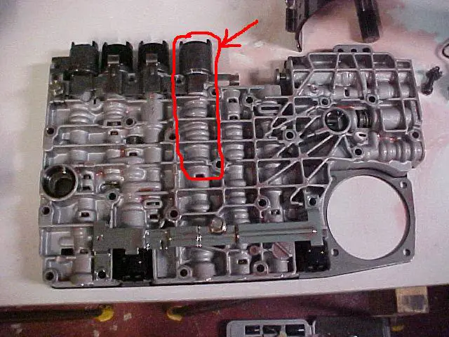

This can be done without removing the valve body on the 5R55E. Once you remove the pan and remove the filter, this is what you will see (with some electrical connectors that have been removed in this photo):
The circled solenoid is the one responsible for the 2-3 shift (could you confirm this Glacier? Bore 203). The four solenoids on that side (driver's side) are held in place with a bracket (three bolts). Once you remove the bracket, you can pull the solenoid out. Here is what the end looks like:

Brian are all the servo's Ohms the same? I Got 5.4 ohms on the one with the screen (probibly bad) then 27 ohms on the next two to the left (photo) an the far left was 11 ohms (probibly bad) . I'm assuming that they all should be between 26-27. Going to get 2 new ones to see....

The EPC solenoid will have a resistance between 3.1 and 5.7 ohms. (the big one). That one is ok. The TCC solenoid will be between 8.9 and 16. ALl the rest will be between 22 to 48.
No second can be caused either one solenoid stuck ON, or another one stuck off. However, in either case you will not have 5th gear. Try applying 12 v to each solenoid and listen for a click.
One the side with 4, the one closest to the end is the TCC and the other end is the EPC, the 2 middle are shift solenoids. On the side with 2, they are both shift solenoids.
Brain: The circled one is the EPC... a partial clog there could account for the symptoms. Also the SSA solenoid (on the side with 2 and across from the TCC) or the SSB solenoid (right next to the EPC) are both used in the 1-2 shift.
The SSB stuck "OFF" will lose the 1-2 shift, and the SSD (Coast CLutch Regulator - next to the TCC solenoid) stuck "ON" will similarly lose the 1-2 shift.

bersanot...sorry for giving the wrong resistances for the two. I noticed that one of my solenoids would cycle on/off after about 15-20 seconds of power (obviously bad) but the resistance reading came out OK (27.9 ohm). The only way I could tell this was by shooting (a bunch) brake cleaner through it while applying the 12V signal (really 13V). There was no clicking sound during the cycling (partially closing/opening) but the cleaner would start to shoot out the "off" position ports .
The reason I picked on that particular bore (203) was because it was the 2-3 shift valve in the A4LD and it (the 5R55E valve body passages with the separator plate and body channels) ran through to channels that went to the right locations.
