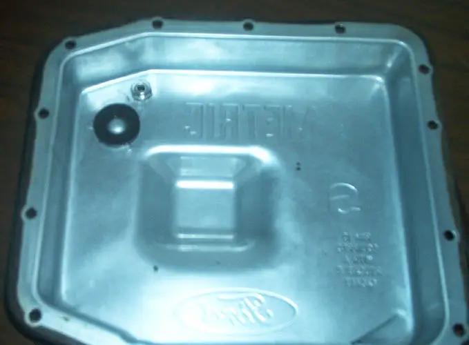

I started by draining the transmission fluid and removing the pan and filter. Last year, I had installed a transmission pan drain plug, came in handy this time around:
I took out about 9 quarts of ATF, and refilled about the same. Only 5 came down in the pan, the rest came slowly dribbling out as I dropped the valve body. I disconnected the electronics, and then removed the 25 8mm bolts that hold the valve body to the trans body. Two of them also hold brackets for the shift selector. I removed all but 4 bolts, and then let the valve body hang on those bolts while I held it in position. It's very heavy! If the valve body doesn't drop onto the loose bolts, you most likely missed one. The gasket's don't have enough pressure to hold this thing on. There are no linkages holding on.
