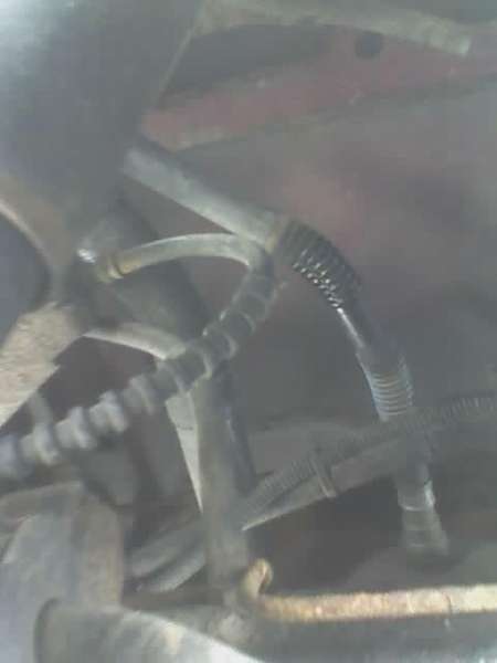

I used the latch on the pump handle to let the tank fill itself and when it hit the point where it shut off, i happened to be far enough away to notice a decent amount (maybe 1 cup) of fuel spill out of an elbow for the 2nd tube going into (coming out of?) the tank - not the larger filler tube, the one directly to the right - will get pics later.

Here's a shot taken at the gas station - dead center is the leak - note it curves from upper-left, behind the shock, to lower-right into the tank.
The smaller tube would be the "vent hose" coming out of the tank and going up to the filler neck. It is quite possible to lose a significant amount of fuel from this line when accelerating and getting the gas "sloshing" around if there is a large enough break in it. You'll lose fuel to evaporation as well, like leaving the gas cap off.
Regardless of how small a leak it may be, it should be changed ASAP, not just to save gas, but for obvious safety reasons, as gas tends to "creep" along where ever its leaking, and an ill placed flick of a cigarette or match by an unsuspecting passerby won't go all to well with escaping fuel and vapor.

A quick fix can work temporarily, and Duct tape *might* work ( that used to be my motto, if it's broke, DUCT TAPE it!..lol )
But there are other cheap fixes as well. You could coat the entire area of the hose where its leaking with Black RTV and let it dry, then duct tape it, would ensure the fuel wouldn't be leaking out and eating away at the duct tape itself, or, you could find the leak, and if its a simple crack, cut it and insert an appropriate size nipple or tube and secure it with hose clamps.
Anything could work temporarily as long as it prevents the fuel/vapors from getting out. :D
