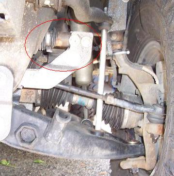

I can't see that the superlift has a bad angle to the rack (tie rod). The lifted spindles change the tie point for the steering as well. I think superlift did a better job by including a complete spindle, rather than cutting corners with drop brackets and ball joint adapters. Just my $.02.
Both superlift and Trailmaster use drop brackets. You have to on a suspension lift. The spindle DOES NOT change the tie rod point for the steering. The place for the tie rod is moved up on the spindle, but if you look at the rack itself, the angle on it is bad! I don't think you are looking at the right stuff. Look at how the boot is off of the rack -- it is angled down. I included two pictures to show: but yes, the tie rod joints have the same similar angel, but the Superlift one seems to put more stress on the rack!

Yeah that angle from the tie rod to the rack does look kinda large. It does seem that when turning the rack would have a lot of upward force put on it? I guess that just means don't turn the steering wheel while your parked, which I try to avoid doing anyways...
That is a good habit to get into. But I haven't heard any problems from people with the Superlift kit about the steering. So, I guess it's okay.
