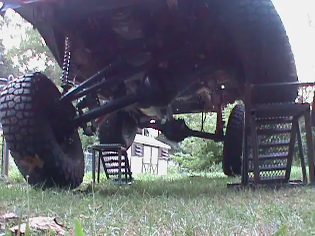

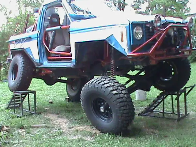

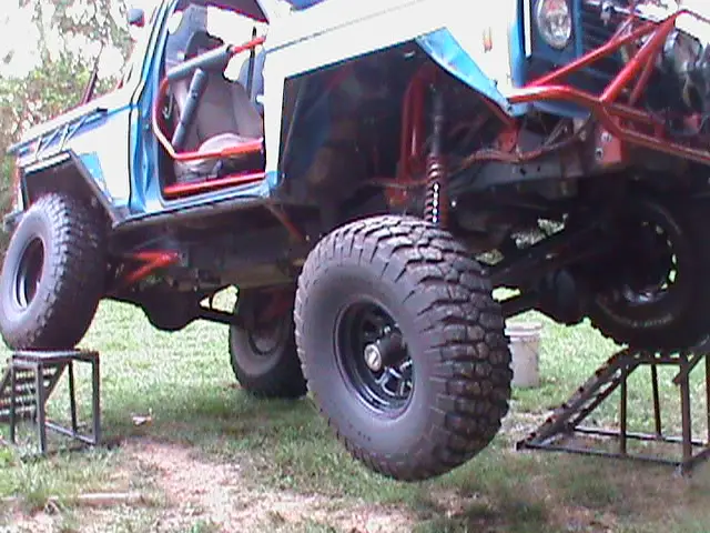

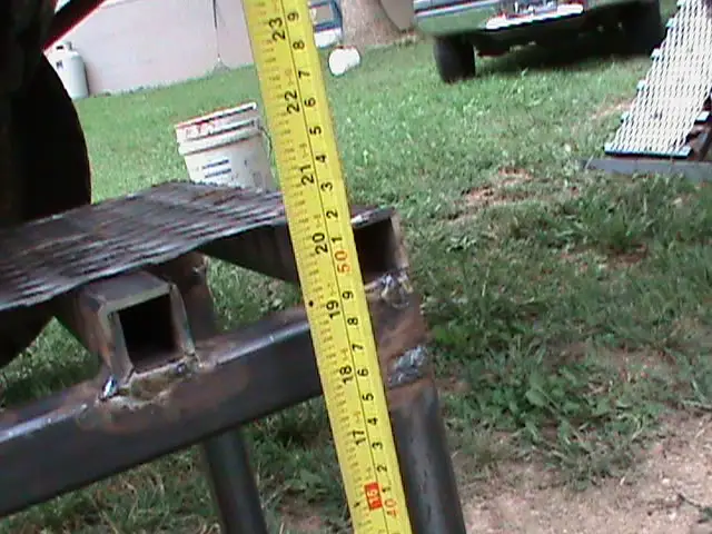

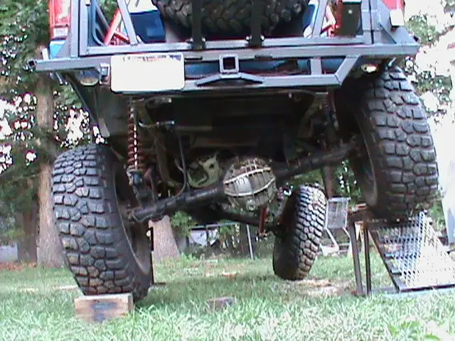

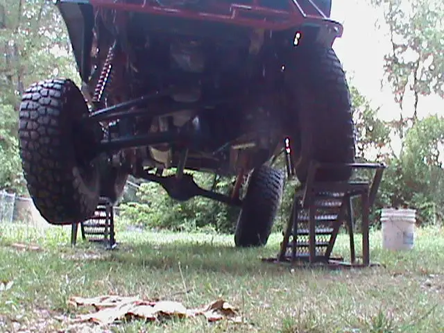

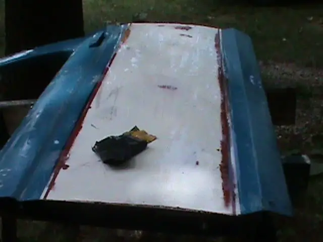

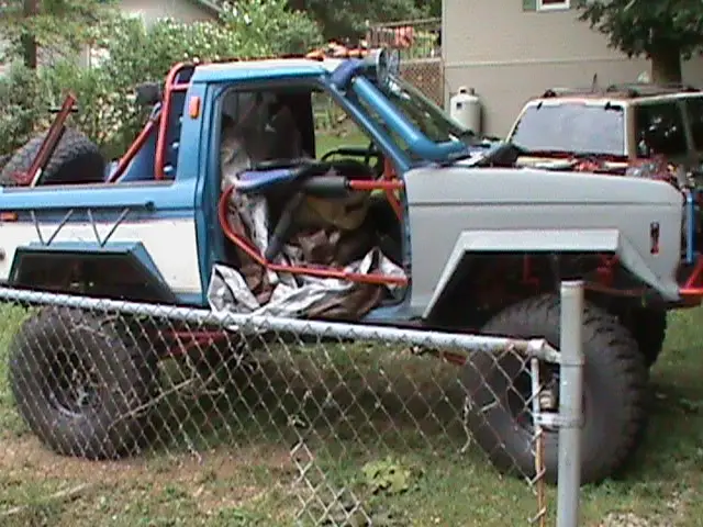

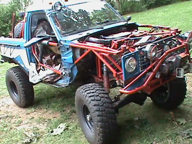

And here you go Maniak. Went back out and realized I would need something higher up then angle. Plus being higher up on the tire means that I should be able to see the back end of the ramp start coming off the ground. A sure sign that I've reached the limit. I purposely allowed for lager diameter tires by moving it slightly foreword more then it needs to be for these 35s. next was to weld it in place.
After making these ramps per FireZappers verbal plans I quickly realized that this is the most beneficial tool I have in checking out the flex that this truck has or not has and not even leaving the comfort of my backyard lol. Not that this is the end all of end alls, but it sure is close. Check out the many pics especially when the rear radius arm is pinned and then unpinned to let this truck flex.
Quickly learned that there is a whole bunch more of the rear rear well has to be cut out and longer travel shocks are a must if I'm to get a total of 40" of working flex. I'm very close to that now even with outboard mounted rear shocks. Not going to change the outboard location, love the way it handles these curvy roads.

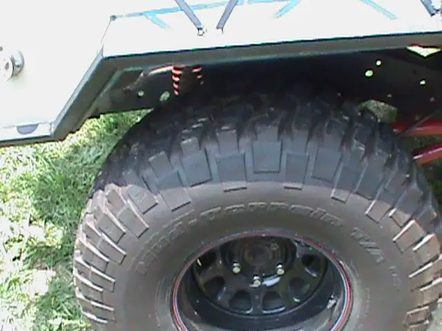

Now here it is with the rear wristed radius arm suspension in street mode with the one pull pin still in place.
Notice the front right tire.
I backed down the ramps and pulled the pin and went back to the top of the ramps, remember these are 20" high each. Like I said earlier, it's a cake walk to do one, but two at opposite corners is a different animal. Now check out the same tire. Also notice the lack of air space above the top of the rear tire compared to the pic that still has the pin in place.
All that stuff come with a price...more trimming. In fact I'll need to redo part of the exo. But first I want to see how the upcoming 3 point will do. With the anticipated less rear steer there might not be any or not much trimming.
Now this is the same rear tire which is in the first pic with the pin still in place with both tires on top of the ramps. Less stuff and hardly no rear steer.
Click pic
Here after welding on the stop I can look down and see the rear of the ramp start coming up as I touch the stop. Then just let of gas and tire comes back a little to level ramp out. Now I can do this by myself.
Would help also if I would turn down idle when the Atlas is in low. It wants to lurch forward as soon as I let off brake. One foot on brake and other on gas is a must.
Here is another pic of the rear axle pinned.
And now with pin removed. From street mode to trail with a pull of a pin lol.
Also notice the way the rear body sits more parallel with the ground amd more air space above the rear driver side tire when the pin is removed. In fact the whole body is now more level inabling the front tire to touch the ground.
<a href="http://smg.photobucket.com/albums/v81/honda2nr4life/Flex/?action=view&amp;current=DSC00410.jpg" target="_blank"><img src="http://img.photobucket.com/albums/v81/honda2nr4life/Flex/DSC00410.jpg" border="0" alt="Photobucket"></a>
Actually a little over 20".
Due to the amount of rear steer when the pin is removed the rear tire is not as far on the ramp as the front tire, even though they both started the climb in the same exact relation to the ramp. I'll just have to adjust the ramps next time so the rear wheel starts up the ramp first by a couple of inches. i dont notice this much going up the ramps other then a slight turning of the steering wheel to the left.
Been a good couple of days. I have some good documented benchmarks to go buy now for many more mods to come. Hope you enjoyed the show

Looks good! Your getting a lot more travel out of the front axle than I thought you could for how short your links are. How long are the front links roughly?

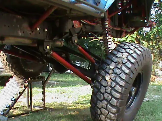

Thanks Kert. Remember the coilovers are not letting it flex even more. There's substantial more travel once longer travel shocks are installed. And also the rear right tire is stuffed so much it's hitting the wheel well.
What i did was to run the top link about as long as I could without getting the frame mount too low. The top link determined my bottom length. So since I got 18" top link then what I did was to make the bottom link length a minimum of 1.70 times longer. So what i settled with was 32" long which is over 70%.
Can you only imagine with longer travel coilovers and a rear triangulated 4 point... Then climb those ramps.

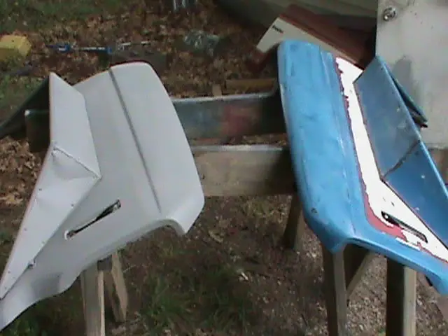

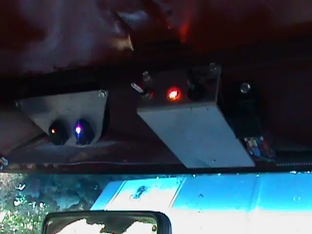

Working on the aux fan switch and relay mounting position. Going to have the switch mounted in the same aluminum overhead plate that my roof top off road light is mounted. Also the relay will be mounted there in plain sight. The main power that runs the fan is wired straight to battery with fuse. Then to the #30 term. on relay.

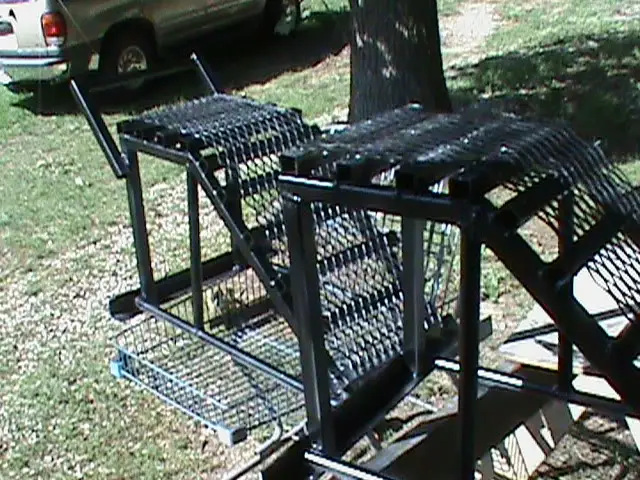

Also put some primer and a first coat of black paint on those ramps.

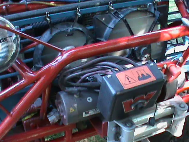

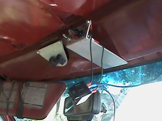

Aux fan mod is done. The fan switch is the far right with it's relay right next to it. I have all other switches on also with lights on to remind me that I have my aux lights on ha ha. Those relays are also in plain site along top of roof. Even my electric fuel pump relay is in cab behind seat in full view. In fact one day my engine died and it acted like a fuel problem. All I did was reach behind seat while still sitting and did not feel the relay pull in when key was turned on...problem solved.
Now I'm thinking of just leaving them there permanently.
The short drive to get some Dunkin coffee this morning I just left them on when I went inside. It brought the temp down a few degrees once I started the engine.
Right now it's just Mall Rated fans, but soon to be Trail Rated LOL, that'll be the real test.
Also some fan shrouding is in order for even more cooling. A lot of air going out the sides and top.

If your going to shroud those fans, only shroud straight back and not flare out like the factory shroud that was on the back. You don't want to force all the air that is going to the radiator to go through the fans.
In my experience, pusher fans can help in slow speed stuff, but they actually hurt the cooling performance at higher speeds since the spinning blades actually block air..
btw.. if/when its time to replace those fans. Look into the A/C condenser fan from a Geo prism. I'm using one of them as a trans cooler fan. Mounting was pretty easy and they come with a metal guard/shield on the front.. New (Dorman or TYC from rockauto) is < $50. I paid $15 for mine (both times)...
Oh yea.. most fans are much less efficient when run backwards (I noticed your using a puller, running backwards). Switch to a real pusher fan will give you more performance since the blades will be running in the optimized rotation.
edit: picture of a dorman version from Advanced Auto parts. Its more expensive there and not quite as nice as the factory one.
~Mark

Are the Geo fans pusher fans? I agree about blocking air at higher speeds. Now since the wiring is done, switching fans would be very easy.

I know about running the fans back wards as far as the air flow goes. The larger fan is just a slanted blade and really don't make much difference, but the smaller fan does have a concave/convex shape which does hurt the airflow when running back wards. Still moves a fair amount of air. But I agree that two designed pusher fans will be better. I'll check out some parts dealers for those fans. I'll at least replace the curved blade fan for now and the other later depending on price.
Really like the metal screen also.

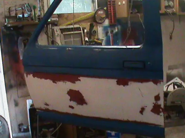

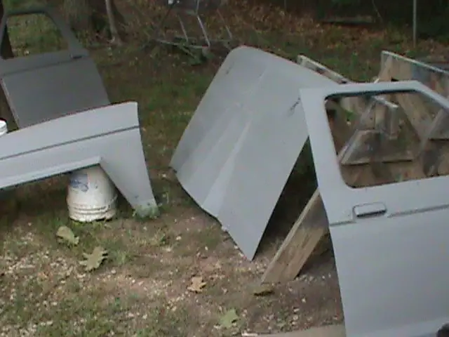

Going to order Summit's Hot Rod Satin Black in a few days, so might as well start the sanding process. Not going to take down to bare metal.
Wet sanding the doors and then I'll hit with a coat or two of primer next.
I'll have my son's compressor by tomorrow since mine broke along with an orbital sander.

The dent stays.
I like the way all solid color makes the length look shorter.
Hood, doors and fenders are being painted in the garage.

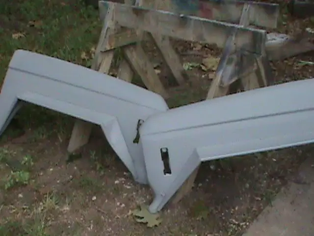

Even though my garage door is not working it was just a matter of minutes to get doors, fenders, and hood into garage to paint.
Never did this thought enter my mind when i made those parts quick release.
I need to design a remote so I can drive this thing around in my back yard from my dining room window like one giant remote toy LOL
Could have just sanded the body panels with no primer, but i like the way the primer hides tiny imperfections.

Made a startling discovery You use less primer once you dice the top I'll order the Black in 3 to 4 days.
And guys, no more talk like that, I'm getting all mushy inside
I'll have a better quality camera once painted, that's unless it turns out like crap and then I'll use the same video camera I'm using now that's set on pictures. Geat videos but lousy pics.
I have always liked blackwalls on black rims coupled with a black truck. NO more color changes.
Did a quick research pertaining to my 103" wheelbase. Of course longer then a stock B2, about an inch or 2 longer then a Ford Explorer 2 door Sport, shorter then a Ranger and much shorter then a 4 door X. A bit of useless info.

Nothing like a warm summer shower to do some Wet Sanding.
Now none of this primer is over bare metal but over all the existing paint that as been on this rig. So no moisture is getting to any bare metal. The existing paint was sanded first then the primer over it. The main reason I primered it was to hide all the sanding marks that I had where all those different color body panels were.
Then started the usual med to finer sanding finalizing with 800. Ran out of 800 for the hood so I had some 1200 to do that. Smooth as a newborns bottom.
I've done this exact sanding in the rain before with great results. Just have to time the spraying of the black with the correct humidity level.
About the 2000 Xplorer, installed a new 02 sensor which did not help that much. But the one that really turned the tide was the EGR vacuume sensor. When I Ohm'ed it out there was no resistance (0000) between the two prongs. So replaced that and runs much better. May replace the actual ERG and the tube that comes off the exhaust. Seems the last owner tried to remove it and twisted the tube. But much better is stil not good enough.
