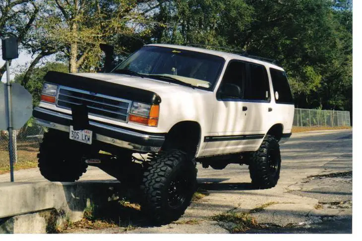

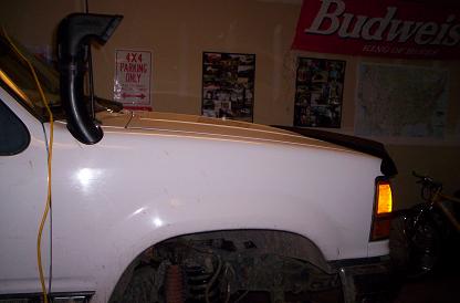

does this help

how did you make that snorkeli like it can you give me some general pointers on witch way to go or start.

well first set a budget and then toss it out.. no kidding.. um look like he used pvc conduit for electric work. you can get it at home depot. first this is what you have to do tho... call around and get the snorkel head. after that its all cake.

Actually thats almost exactly how i did it.I ordered the scoop paid like 60 bucks. It took 3 months to get so i had plenty of time to sit and come up with a plan..It is electrical conduit. I had a kkm intake but couldnt find a housing big enough for the cone to go into. So i took it off and went back to the stock box and sealed it off. And drilled a 3 inch hole in the side of the box and used this threaded plumbing piece that fit right in and had a nut on the back. It goes right under the fuse box threw the inner support of the fender (which has this support box that i totally cut out. 7 hours ) and and up out of the fender. The seal on the fender that goes around the snorkel is just plain old vacumm tube split down the middle. The hardest part was the hole in the fender i started small and just kept test fitting after every cut till i got it right.. hope this helps... The total on the whole project was like 90 bucks give or take 10 bucks.. Ive had the snorkel on for 2 years now.ive had no problems and have been in water as deep as the bottom of the windshield.( dont recommend on doing it nor will i ever do it again). carpet tranny,axles and cab of truck all full of water hahah.
splodo49 - your snorkel looks good man. id like to do that to mine sometime soon! do you notice any power difference or a sound difference like a k&n cone filter would give you? just wondering!
snorkel
I did notice a power diff. from the kkm back to stock. Lost the little kick that the kkm gives from the get go. But with the snorkel I noticed a power diff. at about 30-40 mph when the snorkel acts as a ram air .But that’s about it.
If you put your ear up to the snorkel head you can hear it sucking. When I first put it on, I was afraid that the snorkel head wasn’t going to throw all the water out threw the little channels on the head when it rains. But being in florida at the time I drove threw one of the worst rain storms I’ve ever seen in my life. And pulled it into the garage to check the box and see if the filter was wet or any water in the box.. Their wasn’t any so the head works really good at channeling the water out..
When you first get your snrokel head have a buddy drive you down the road and just hold the snorkel head out the window and feel all the air the head forces threw it, youll be suprised at the amount and force. Good luck to who ever is going to do this. And i take no responsibility for your modifications. :D O yeah be prepared to hear alot of " Whats the thing poking out your hood? is that a periscope?" I hear that every where i go.
thanks for the ideas splodo49. just one other question who makes the snorkel head? thanks again
