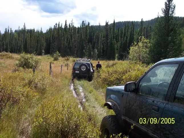

a lil bit O muskeg anyone?
endless trails out here :D
thts very cool
hard to tell but this ditch wuz about 8' across and 6' deep... i yanked the twisted old culvert out of the bottom of the creek with the winch and then watched every rig in the party bang there bumper climbing in or out.... DEEP STEEP drop off and climb out..
this weekend cost be a drivers side stub axle and a C5.... i took on alot of water in the first pic and some found it's way into the tranny... it's only money.... :D
