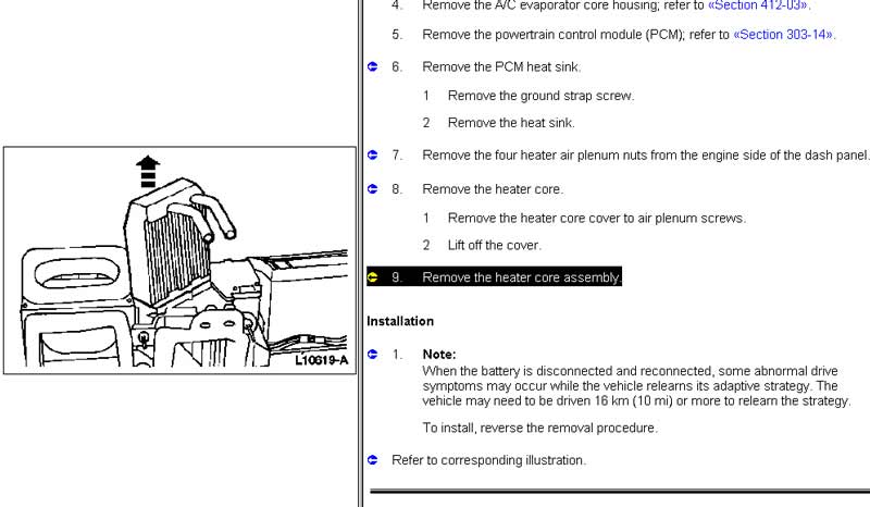

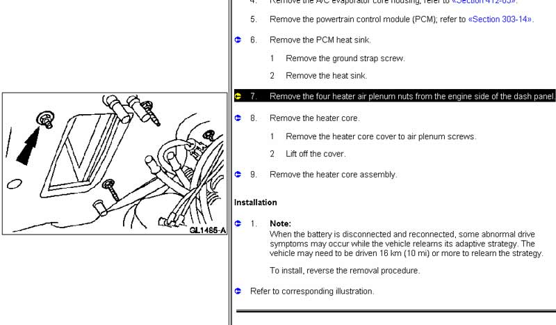

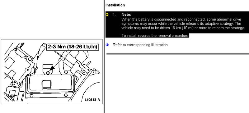

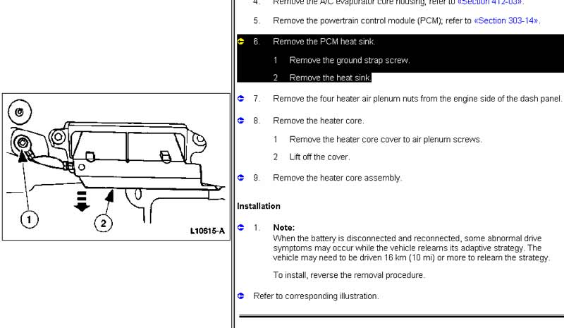

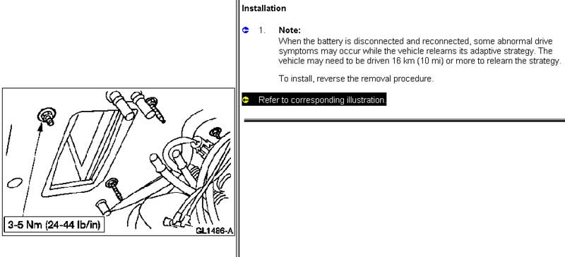

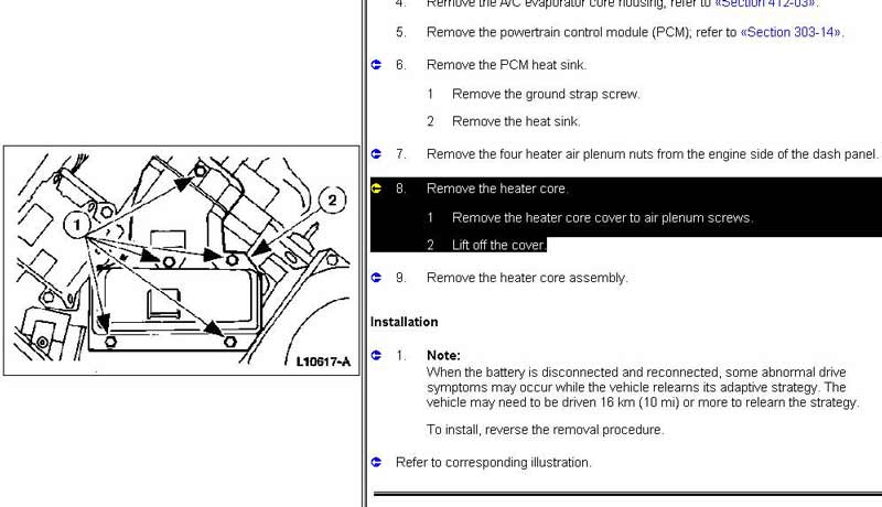

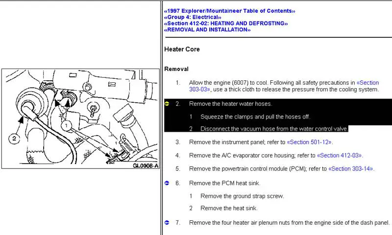

I found the heater core removal steps in my CD manual. If you search for the blend door problem you should be able to find a couple of different techniques to fix it. One forum member removed the whole dash to fix it, but there are a couple of clever fixes that save you from all of that labor.

I notice that in Step 3 you need to remove the instrument panel, and Step 4 you need to remove the A/C evap core.....maybe you should just trade it in for a new one? ;) :D

As a veteran of doing the heater core twice and getting ready for a third one. There is no other way to get the heater core out without taking the dash out.
Your problems sounds like a vacuum hose is leaking, probably the resevoir (ball looking thing down on the front of the frame under the air filter housing (at least on a '95 OHV)
The first time is a bit daunting but it's not hard, just take your time and you can have it done in a weekend, if you work fast, you might have it done in a long day.
But there is a trick that might work for you, go to the Ford dealer and see if they got a restrictor per a TSB
