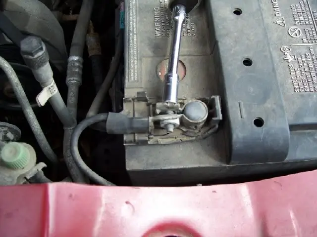

First off disconnect the battery,using 8mm sosket.

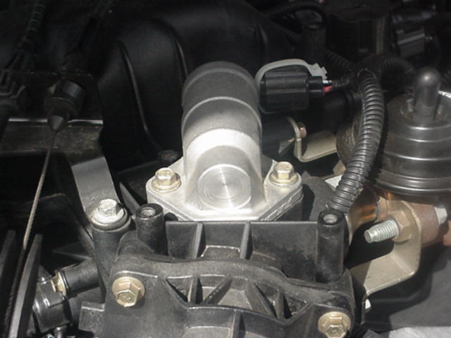

I'm starting off with the IAC(idle air control)In my case mine is in need of replacing but I thought I'd clean it up anyways.
Disconnect the electrical connector,I'm usin a picke here just to point out where to push to release the connector
Time for the 10mm socket
...and here we have 1 carbon'd up IAC
Time for cleaning,I used gumout carb jet spray
I use compressed air to dry it out,and then reinstalled it.
In my case I have the howling intake issue so I removed the breather cap to keep the noise away but is on just for the picture.

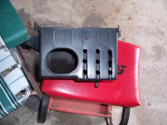

The followin I did a while back its called the swiss cheesed air box mod,which allows more air in.Future upgrade will be an air intake kit,and hi flow exhaust.
All I did was drill a bunch of 1/2" holes in the box,elininate the restrictive air horn and the plastic shield behind the headlight to get as nusch air in as I could,but be sure to only drill the holes on the headlight side and fender side,this will preven suckin in the higher temps frome the engine.
You can see in this pic how much smaller the air horn is compared tp the actual opening
......and where the plastic shield was that I removed

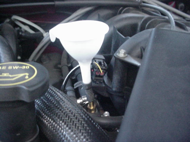

There is actually an easier and more effective method of cleaning out the sludge and carbon buildup in your TB and intake...
Go to your local parts store and get a can of Seafoam fuel system cleaner, it's in a white and red metal can. Start your Ex up and pull the vacumn hose off of the brake booster and stick it in the can of Seafoam and let it suck up half a can, then shut your engine off and let it soak for 5-10mins and fire it back up. It will smoke like heck for about an hour but that stuff cleans like no other!
Seafoam Deep Creep in a spray can works awsome for cleaning out the intake
No not the brake booster vacum line we discussed this already on a previous thread. Use the IAC hose on the air inlet tube, works awesome. SEAFOAM BABY.....

Still feel the PCV line is best
I wanna do the seafoam treatment but where I bought my stuff at was out of it so I elected to do it with ye old spray can.
Wish I could find BG products down here that stuff is the best.
When I do I'll update here.Theres a few good pics here alrady on where to perform it from.I was told from a Ford tech at where I used to work at to use either the PCV or booster hose.

What's that black nob on that IAC ?
Mine doesn't have one...
The black "knob" is the vent filter for the IAC. Its supposed to keep dirt out of the area where the piston moves back and forth. Yours must have fallen off or been removed by someone.
Edit: Or you have the other type of IAC valve. His pictures show a 2nd Gen.
Or it could be an aftermarket replacement, after 01 even the OEMs had no vent, most likely the reason they fail so often
