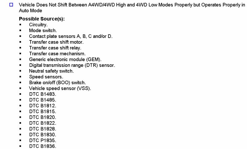

Hey folks, I just got a 98 a week ago, its an automatic trans,I noticed it takes a while to go in 4wheel low, then, when trying to put in reverse, it grinds, same with park, had to put in neutral and shut off, put back in park while off, then restared it, and shifter moved, as moving more in park, any ideas?, Its my first ford, and 4x4 so any help appreciated.
