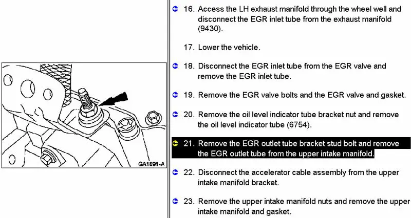

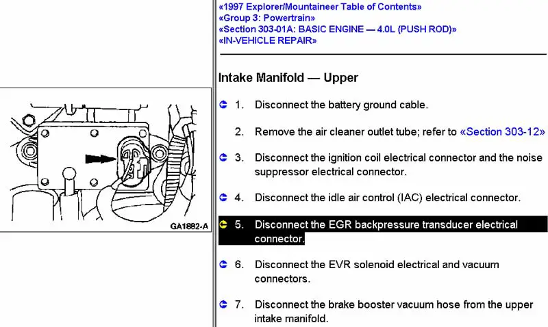

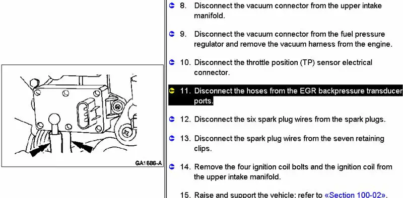

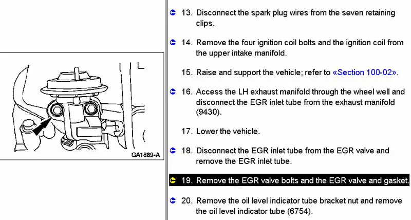

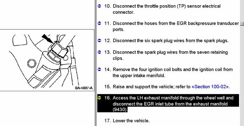

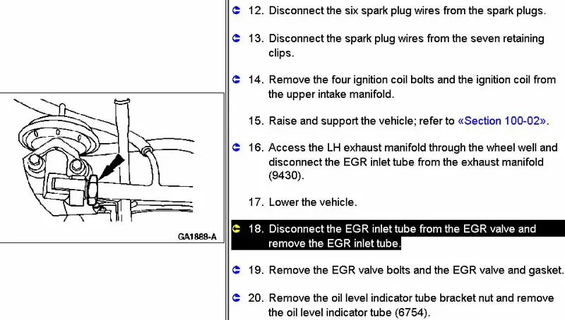

I have the instructions from the 97 shop manual. I don't know how different your setup is, but maybe this will help.
more
Dogfriend,
THanks for the post. Great detail! Item 21 (or the photo next to it may be what I'm looking at. On mine (from my research I think they changed in 00), a tube goes from the back of the EGR up into the intake. The bolt it says to remove in step 21 holds the oil dipstick in place. I took that out, but it didn't loosen the bracket at all that the TUBE is attached to (the tube is welded to the bracket).
Still trying.
