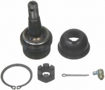

OK, I have the lowers figured out...
MOOG Part # K8695T
Frt Susp; Lower; 4WD; Enhanced Design, 2 Required {Ball Joint}

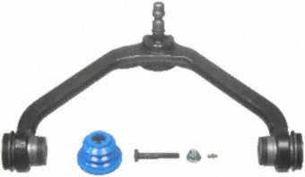

And the upper left hand...
MOOG Part # K8708T
Frt Susp; Upper; LH; 4WD; Enhanced Design; Incl. bushings {Control Arm w/Ball Joint}

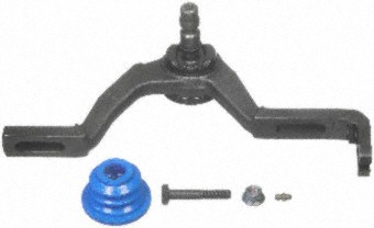

But there are two differant ones for the upper right hand...
MOOG Part # K80068
Frt Susp; Upper; RH; 4WD; 1 piece design; Incl. bushings {Control Arm w/Ball Joint}
MOOG Part # K8710T
Frt Susp; Upper; RH; 4WD; Enhanced Design; 2 piece design; Incl. bushings {Control Arm w/Ball Joint}
Anyone know the differance? Which should I get? :confused:

First pic is just the lower balljoint.
Second is the upper left hand.
Third is the Enhanced Design; 2 piece upper righthand.

Unless you KNOW you need the bushings on the right upper, just get the 1-pc RH upper. If you take a look at your X, you'll notice that the unit in the lowermost pic actually bolts to another "control arm" that actually connects to the frame. That is what the 2-pc design looks like.

Yeah, that's right - the DriverSide is one piece, a V-shape and includes the bushings (see pic on right above). The 2-pc PassSide includes the ball joint & arm (see lower pic above) PLUS the control arm part with the bushings (not pictured). The ball joint & arm bolts to the control arm on the passenger side (see lower pic again; note the alignment slots in the arm). You technically do not need the part with the bushings, just the outer ball-joint part, but if you bought them and have it all apart anyway, you might as well install both parts and save yourself trouble down the line.
