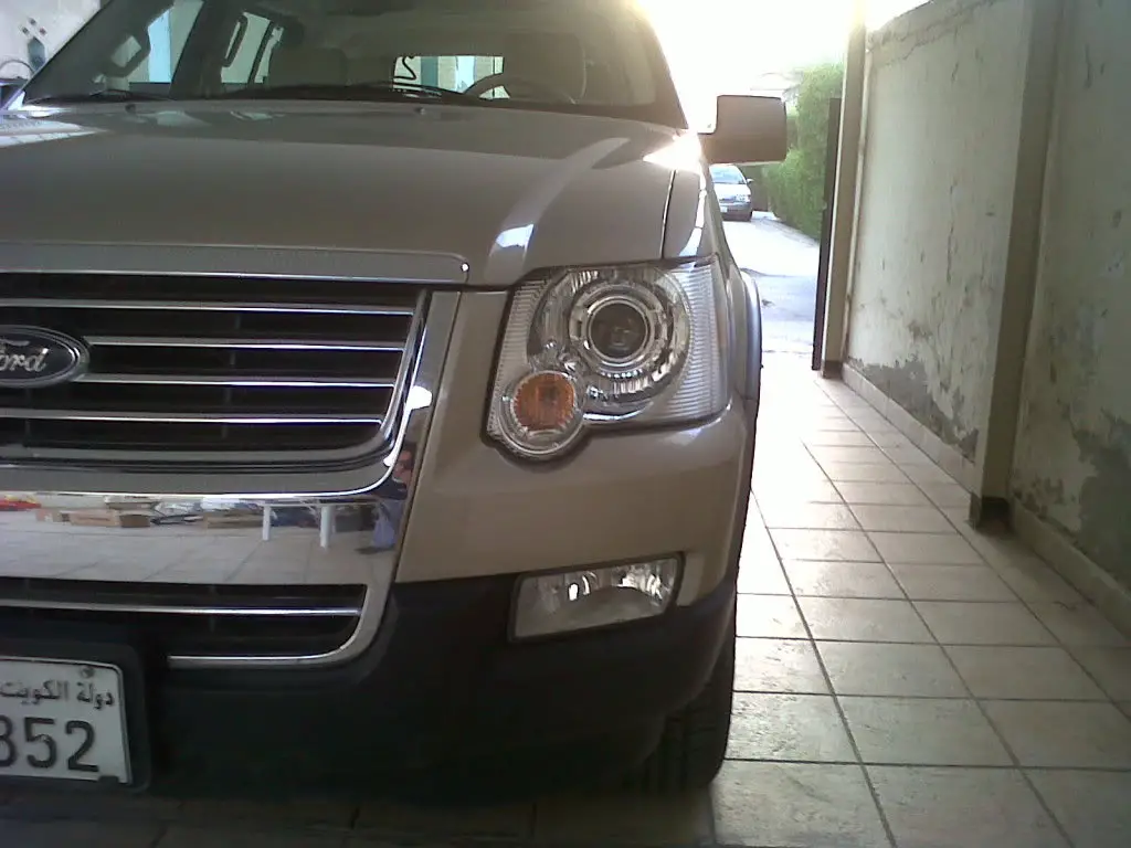

Thanks Alienman8. Actually, your sport trac encouraged me to do the retrofit.
Here is a quick pic taken with my phone.
I have high resolution pics of the whole process but I'm currently insanely busy and when I have time, I'll post a complete writeup for the retrofit both here and on hidplanet.com
that looks really nice man, Apollo shrouds yes? it also looks like you pushed the projector back really far unlike me (you can see behind mine, but meh I didn't care
I'm glad people liked mine so much that they are being influenced by it and since you seem to already have them in, the comparison between the stock and the retrofit are night and day, no pun intended. I would neverrrr drive with the stock housings in my car again at night, just isn't the same.
