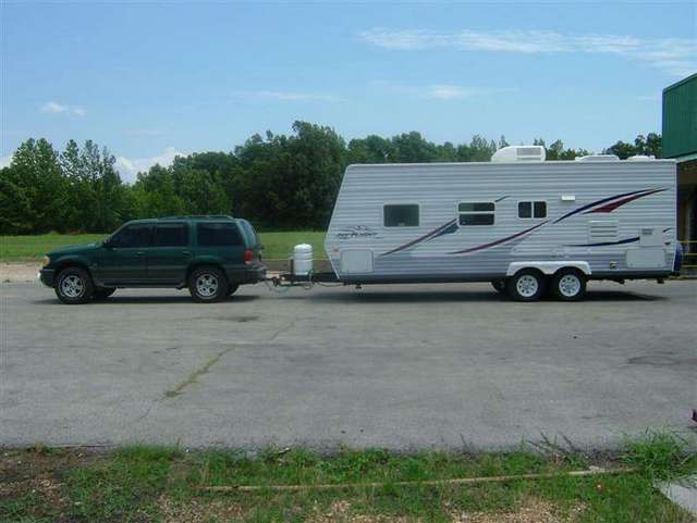

Here is my new hitch and plug set up- ignore the dirt, its been really dry lately!
And in case your wondering, I did cut a big hole in my bumper to put that plug in

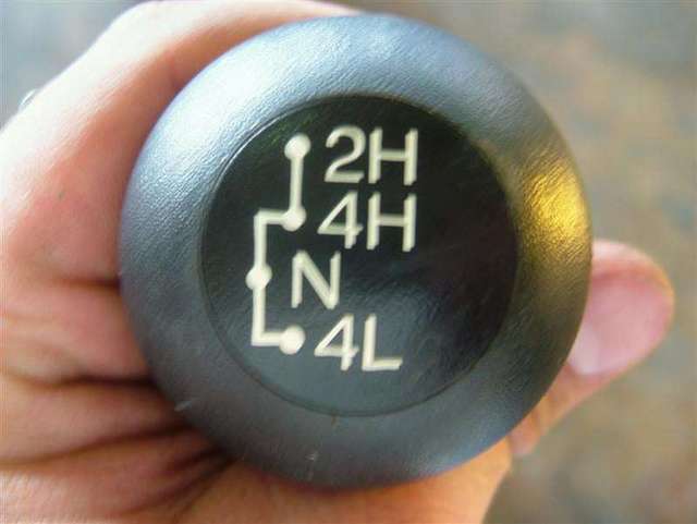

I did a transfer case swap to get 2wd, 4wd, and 4low. Im loving the extra fuel mileage and power by being able to drive in 2wd.
My thread on the swap is here:
http://www.explorerforum.com/forums/...d.php?t=166726
The lift kit is on hold for now. Now that I have the different case, a custom driveshaft can be made much easier eliminating the need for the superlift shaft. I need a few brackets to install the kit, but I must wait until I have a different tow vehicle for the travel trailer. I don't think the lift will help any with towing. Or would it??

Im not really worried about the 8.8. What I don't know about is how the added height will affect my ability to control the weight behind me.

right now you sit pretty level and that is a plus its better for the tongue to be higher then lower IMO. im subscribing, I like the changes you have made/make and your right ups.

When i was stock i had about 500 poumnds of luggage and other crap with me when the family went to the airport for a vacation....stopping was a biatch. Just recently in the summer, i loaded the mountaineer with 1300 pounds of brick in the back and accross the fold down seats. Acceleration was good, but again brakes.

Well brakes are not an issue with the electric brakes on the travel trailer. I can stop pretty much as I please using them.
