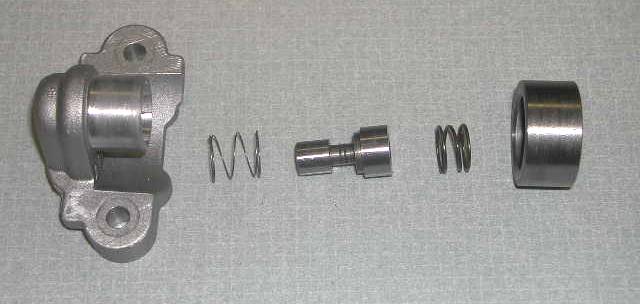

I often get questions about the governor on the A4LD. Where is it? How do I get to it? What does it look like?
Well a picture is worth a thousand words.... the governor is attached to the rear of the case... well... to a "shelf" on the output shaft... Here it is:
Another view:
To get to it you need to remove the transfer case, leaving the extension housing....looks daunting.... but you know what is inside... now you CAN remove the extension housing if need be...here is a view with the extension housing installed... hiding it.... remember you CAN remove it....8 bolts....
But why ? See our prize down inside... can be removed without removing the extension housing.
I will admit, on your back .. under the Explorer this doesn't look so easy.
I hope this helps someone.
