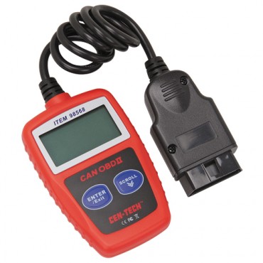

I have a 2005 Explorer. "Check Gas Cap" message started coming on. Ford dealer quoted me hundreds of dollars to diagnose (smoke test). Parts could be another $200. Service rep turned over the rubber seal on the gas cap and message went away. Now, about two months later, Check Gas Cap message AND "Service Engine Soon" light is on again. This morning I replaced the gas cap. Message and light still come on. I will wait to see if the alarm condition goes away after a few "start cycles" (Ford's terminology).
Does anyone know how to just disable this alarm system. I don't consider myself a environmentally unfriendly person but $400 to turn off a light because of a little leak is just too much.
Also, what do I need to read the diagnostic codes? Is this something that an individual can obtain?

Buy one of these:
http://www.harborfreight.com/can-obd...enu-98568.html
No way to easily disable the emissions system. You can put some tape over the check engine/fuel cap light or remove the bulbs. But it is against federal law to tamper with or disable emission control systems. Doubt anyone is going to hunt you down to check your car unless you live in an emissions testing state. Don't recall if TX is or not.

Thanks for the Code Reader info
I appreciate your recommending a code reader. I will definitely purchase one. Also, thanks for the warning on Federal Law. I have been reading a lot of posts on this site about the EVAP system. I am going to try to run down a few things with hoses, the cannister, purge valve, etc., first before I throw in the towel and go to the dealer. This forum has a lot of good information. I have already considered the black tape on the check engine soon light.
