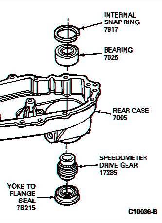

The speedometer gear is attached to the black cable going into your transmission's tailhousing. 4wd vehicles - the speedo sensor is located near the rear output flange of the transfer case. 95, and above did not use a cable. Digital dash doesn't use a cable either. 98, and above started to use the sensor on the rear differential. This is also used for the ABS. There is a single bolt, and retaining ring holding it in. Once you remove the bolt, and ring, the gear, and cable will slide right out. The gear is attached to the cable with a small clip which could be removed with a small screwdriver.
