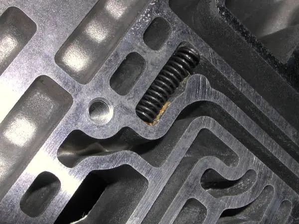

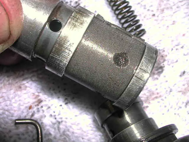

You would have to completely drop the VB to get those solenoids out. If you are already doing this, then rebuild the valve body, replace the TCC screen (it looks like a short filter pressed into the separator plate), and check the spring in the transmission's underside for any debris that might be caught.

This is the filter spring in the underside of the case:
This is the TCC filter in the separator plate:
