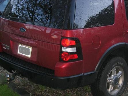

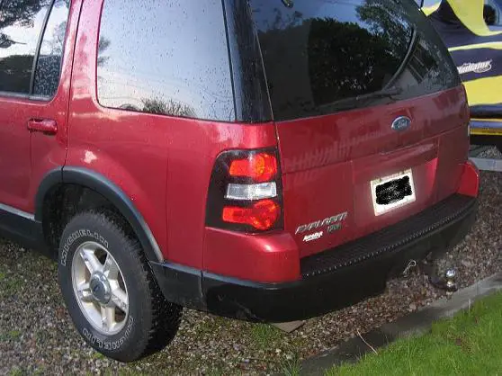

Its not all that hard. A little rewiring and I had to bend some steel.

Just spliced it in. The harder part was the white light you need new sockets. (smaller) had to buy 3 different ones to find ones that fit right, I will see if I can find the part # for the one that worked.
They look awesome.....I love it......What steel part are you talking about that needs to be bent?

That would be the steel I bent out of the way.
I did not cut it like ford did all you have to do is bend it up out of the way.
That looks pretty simple to do.....Now all I have to do is find some 06 tails!
