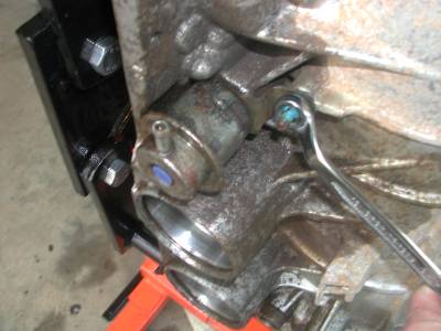

Welcome to this forum! Please post transmission related problems in the transmission section for more responses. Here is a picture of the modulator from Glacier991's photo gallery:
As you could see from the picture, the modulator is the part closer to the rear of the transmission next to the 2 servo covers on the passenger's side under the heat shield.
