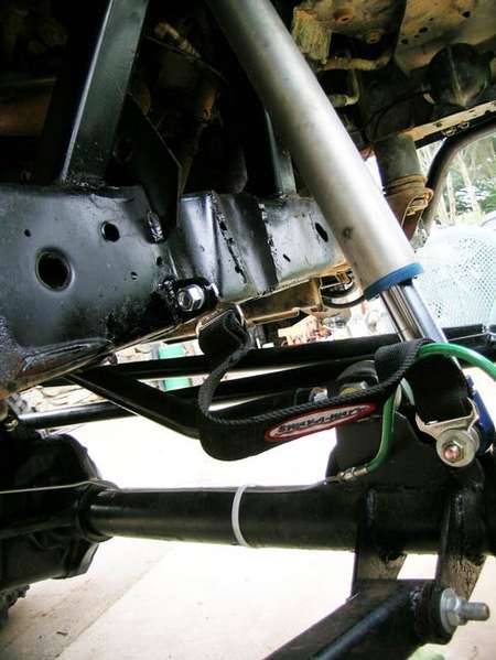

hey got a few pic requests. can I get some more pictures of the final axle setup. Aka some good pics of it under the truck, Some pics of how the trac bar was mounted also.
I'll try to get some good pics of the underside tomorrow or friday - before Paragon.
But here are some pics of the panhard during the build..
The panhard is the one on the left with the odd bends -- which were required in order to "snake" itself between the differential housing, the engine's bottom section, and the upper link mount (which sits on top of the differential)
Here's another shot of the complex bends with the panhard bolted to the chassis but not the axle:
Here's a shot of the panhard mount on the chassis end. the chassis was notched (perhaps too much) in order to bring the panhard and the steering links into the chassis for optimum articulation. Excuse the pitman-arm, that was later removed and replaced with a flat pitman arm (no drop).
Here is a shot of the bracket that was welded onto the axle to which the panhard bolts up to (altho the panhard is not bolted on in the image):
