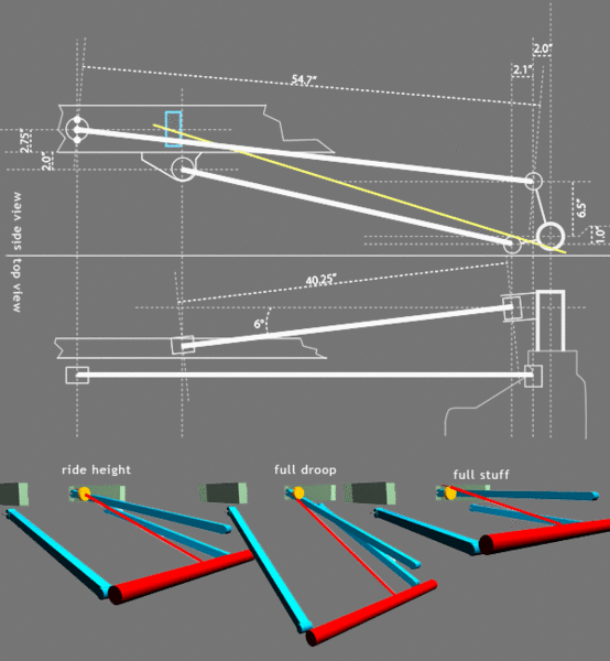

The vehicle was in 2HI in that video. It was just to demonstrate the improperly tuned pair of front air shocks. The shocks are off the vehicle right now and are broken down. I am waiting for a replacement bearing housing from PolyPerformance for one of the shocks as the old one was eaten up by brake fluid.
The 3-link is in the front and does not affect anti-squat. Anti-squat is a property of the rear suspension.

I don't understand your question 100% but let me take a shot at it.
If you're asking what I used to model that design, then the answer is a 3d software package called Maya. Maya used to be owned by Alias|Wavefront but I believe AutoDesk has since bought them out. The package is geared more towards film and animation and therefore the modelling is not nearly as precise as a CAD program. Where as most CADs use polygons, Maya has the ability not only to use polys, but also Non-uniform Rational B-Spline (NURBS) which is not as rigid as polys and is better at modelling nature (humans, animals, terrains, etc...) and very complex surfaces with mutliple curves.
Now if you're asking where I did the actual cutting and welding of the metal to box the frame, I did all of that at my friend's driveway.

Hey there zhanx!
The bends were mocked up using conduit tubing (the cheap stuff). The bent conduit tubing and the DOM tube were then brough to a local Midas muffler shop for the final bends. There are three bends on the tube. Afterwards, it was cut to the proper length, "fish mouth" notched to properly interface with the rubber bushing assembly, welded, and the threaded rod end adapter was also welded to the other end of the tube.
I payed the guy at the Midas shop i think around ~$12 (whatever I had in my wallet at the time) to do all three bends

nice good idea on the conduit. Help me out with my build couple of more questions.
Did you move the axle forward any? and what where your link lengths for the bottom two and top one? How the steering treating you?
Yeah the axle was moved forward I think 3.5 to 4.0 inches.
The length of the arms are 54.7" top and the two bottoms are 40.25" -- all figures are from "eye to eye". Those are the calculated values though. Tomorrow I'm going to re-assemble the links so I'll try to remember to measure the actual values -- but as I remember, the actual values were very close to the calculated values. The upper link is adjustable to adjust for proper ride-height pinion angle. Also, keep in mind that the lower links are "angled out" at the axle-end about 6 degrees.
The steering is fine I guess. I mean I haven't experienced any downside to it yet. Its just steering Well I take that back, I wish i was running hydro-cylinders/rams

zhanxy - you glistening little baby boy -- I got the measurements. Seems like I cut those figures down by about 2-inches. So..
The lower links are 38" eye-to-eye.
The upper link is 50.25" eye-to-eye.
Again the upper link, unlike the lower links, is adjustable so 50.25" is not a fixed number but thats where mine is set right now.
