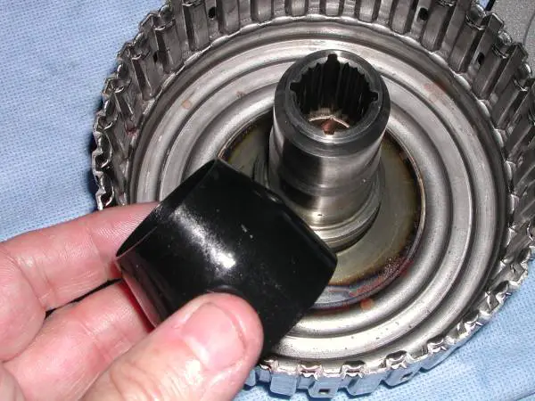

The "pistons" inside the drums have an inner and outer seal on them. They are a ring of a rubber material which fits onto the inner and outer edge of those pistons. Their profile is "L" shaped, and the lip of each doesn't go down into the drum without the tool to "compress" the lip portion. Some people have had limited success by other methods to install the seals. The seal tools are simple plastic pieces that fit snugly inside/outside of the pistons, making the installation a fast drop in step. I think I paid about $35 for the AOD set, I would call that a price to shoot for.
There are a few brass/copper races inside the case and several hard parts. If those are all unhurt then you reuse them. Damaged transmissions often need many of those replaced, which those take the typical seal drivers to R&R. There are a couple of specialty tools for a couple of those, like the rear case bearing/race. Just check all of those carefully.

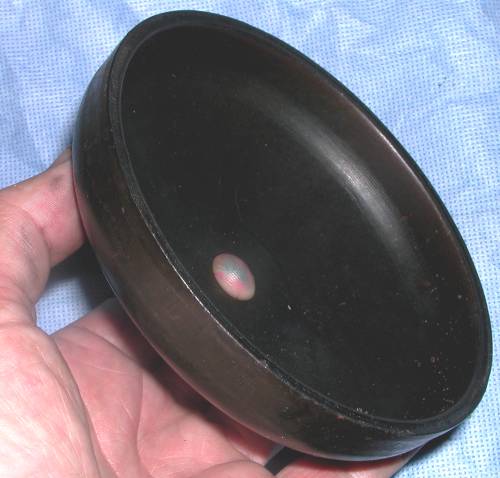

Glacier991, or anyone else out there listening...
I am in the process of getting all the tools together for the rebuild of my wife's 4R70W in her 1998 AWD Mounty.
What is the part number of that Cup Shaped Spring Compressor?

Ryan, I'm not sure what that is for, possibly to work with the piston spring compressor for a certain drum. I haven't R&R'd the pistons of a 4R70W or AODE yet, but the AOD parts are the same size. I'll find out soon.

In his thread, it shows him using it to compress a wave spring lock in the reverse clutch assembly.
http://www.explorerforum.com/forums/...d.php?t=159597

Hmm, I didn't catch that in the thread. I have the same compressor, but I didn't need that special tool to do the wave snap ring. I cannot recall how I did it, but that was about 1998. You can get it done without that, if you need to.

I have purcchased, or already had the following tools:
Lip Seal protector set (seen in various posts/pictures, here are a couple)
Pilot Bushing Puller
Clutch Spring Compressor
I also just bought THIS spring compressor:
Rear Case Bushing R & R Tool
Direct Drive Solid Sealing Ring Installer Kit
I have also purchased a new Digital 6" Caliper, and the 4r70W manual from ATSG...
Now I still need to source the following parts:
Small tipped snap ring pliers:
I still need to buy that bowl shaped spring compressor, once I have everything here, I will make a build diary like Glacier991 did..
Ryan
