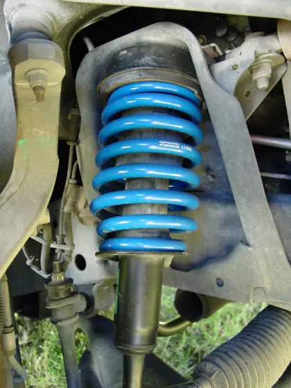

I replaced the 2 front springs today and will get the back 2 sometime this week (depends on work sched.)... You have to really compress the hell out of the stock springs to make them loose in the strut. Good thing I bought 2 pairs of spring compressors from harbor freight (they were only like $12). I really cranked on the first stock spring and destroyed the compressors.
The GF springs wern't too hard to compress to get them to fit. The Pass side top 3 nuts were a PITA to get to, but probably wont be as bad as the rear!
While my X looks like an 80's van with the rear all jacked up, the front looks awesome! I can't wait to get the rears on.

I got home a little early yesturday and installed my rear springs lastnight.
The 3 nuts on the top are infact 13mm and buying a ratcheting wrench (the type with the swivel head) will make the job a million times easier!
I couldn't get the strut out at first, and then I remembered about reading on here the instructions were missing a step. you MUST remove the spindle bolt on the Lower control arm before it will drop low enough to get it out.
The drop was nice, but honestly now I almost wish I went with the belltech setup. The rear should probably be lowered more. However, I'm still very happy with the setup. I need to take it to a shop for an alignment.
Thanks guys for the pointers... it made it easier.
