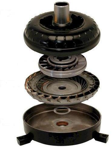

Here are some break out views:

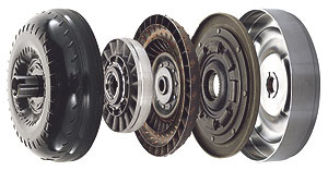

This is a comparison to a clutch:
