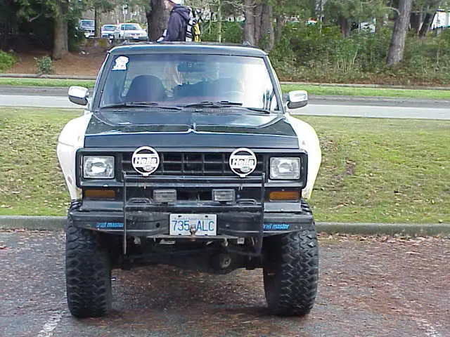

Got the other fender on today, on my lunch agian.. hahaha almost dident make it back to work, this one was a little more fun, had the wheel well still on and I had to take the head light out to get to one bolt. But here it is done. Just need to sand it down a little and than apply the black paint!
Any ideas on what grade of sand paper is good on fiberglass?

looks good!! you need some rims with some backspacing!
Heres a comparison shot, this is 4.5" lift, 4" glass with 15x7.5" rims 3.75" backspacing, 33x12.50 my beams are also about 1.5" wider then stock per side.
That will give you a 7.5" wider stance with jsut the rims alone, more stable as well as filling up the glass

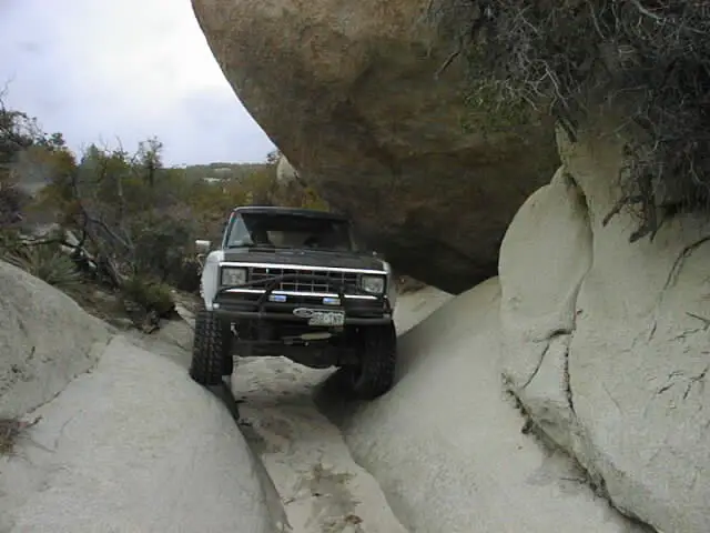

that first pick is "bagby's rock" in Los Coyotes indian reservation, CA
Awesome place to go wheeling
Rick has a pretty good pick of his orange pumkin there
it would be a really great spot to change your oil!
Also if you continue up past this rock it the trail elevates into one hell of an obstacle, they told me it was called "bronco hill" but without a winch and a roll cage there was no way my bronco was attempting the climb!!

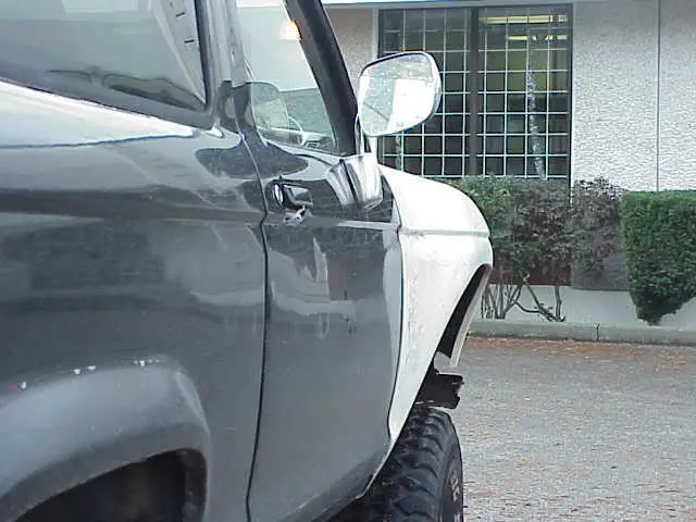

here is a little bit of paint before and after

geesh he did this like 2 days after install, mine have been on for over 2 years
What did you paint those suckers with, it looks good!
Why the odd wheel?
I have refused to rattle can them because I was planning to repaint the whole truck soon after I do some rust repair, well the rust repair has been on the back burner for a couple years now....body work schmody work, we know whats really important!!

I am going to go over it a few more times, but it looks good, I knew some one was going to say somthing about 410's hahaha, but yeah I bombed them, it seems like I will never actually get a real paint job agian on this truck, every time I go out wheelin I end up going though some old ATV path or just going up the mountians though the woods, needless to say lots of crap runs down the side, not even sure how long I will be able to keep these fenders from being smashed off.
OHHH ODD wheel, well I was driving home and went over the train tracks and a chunk of metal ended up in my tire.... It was actually kinda funny, some what, I was on my way home with new tires in the back of the BII for the Explorer, and I was thinking , "Dont really need to bring my spare if I am driving though the city" But the tire held air for the drive home. Just need to get a new spare and change it back

bombed = rattle can?
did you prep the gel coat at all?

rattle can yes hahaha, we say spray bombed... Donno why. hahaha, now not too sure what a gel coat is, unless its from somthing new. But I got these fenders used. Before I painted them I used two different types of sand paper, washed them, than used a black primer than used gloss

gel coat is the white factory smooth finish, like a boat
you done good!!
