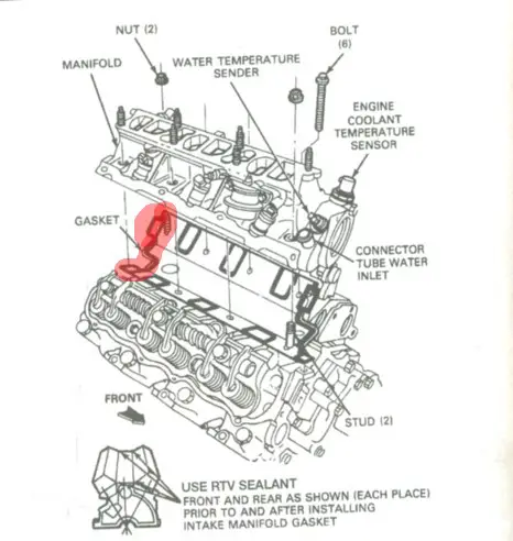

OK, I found the plugs I needed thanks to you guys, I pulled code #118,---Engine coolant temp sensor above max voltage / 0-40 deg indicated. Does anyone know where this sensor is, I see one at the thermostatic housing, could that be it? Is there a diagram showing where all these little buggars are?
ECT is located near the thermostat housing and has two wires coming out of it. The dash sensor sender will only have one wire coming out of it, but will be in the same area.

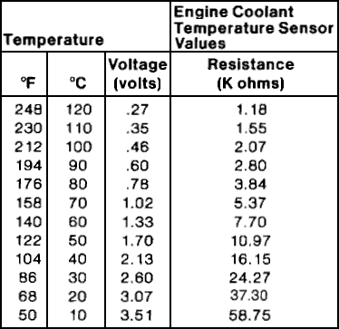

WTS = Gauge, ECT = Computer.
Both should read resistance IAW table.
If no joy, Mr Shorty presents a systematic approach with a very high likelihood of success. Feel free to ask questions after reading the afore mentioned notes in the EEC-IV subforum.
It was shamaal's diagram from the search on the forum that pointed me to the location, I replaced the sensor today, and the cel did not come on as ussual. Thanks to all you guys for your help, I have learned a lot from this forum. Gary
