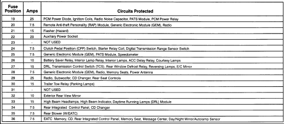

Does anyone have a diagram or photo of the fuse box panel for a 1995 eddie bauer? I keep blowing a fuse but not sure which one to replace it with or even what it's for?

Hope this helps ....

you are a life saver!! Thanks so much!

Here is the other ....
