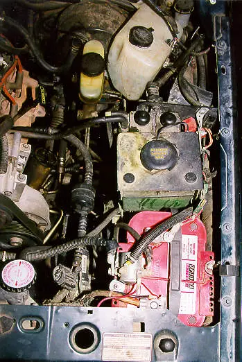

I have a dual set up on my 88 with an isolator, and a solenoid. The solenoid engages only when I'm cranking the engine, then disengages. The isolator is connected to both batteries. If I want to manually connect both batteries, I have a high current key switch which connects (+) to (+). An isolator usually has a .7 volt drop which isn't so noticeable.

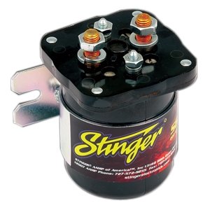

..There are a few isolators to choose from in the 200 amp range..Just for general purposes here are couple different kinds/styles of various amperage...
..One is electrical and keeps the starting battery online at all times and only adds the second battery online after the vehicle has started...This isolates the second battery from starting duty and the primary batter from auxiliary duty while allowing both to be charged while the vehicle is running..
Stinger 200 Amp Battery Relay Isolator
http://www.amazon.com/Stinger-200-Ba.../dp/B001HBYXVS
..The other is totally manual and serves the same purpose as above but also can directly isolate either the primary or the secondary for starting duty at the flip of a knob..(shown with key lock)
http://www.westmarine.com/webapp/wcs...splayErrorView
..This one is like above with a combiner, but 120 Amp..This also has a video on it's page to better explain it but it's geared for boat owners but many use this for their vehicles..
http://www.westmarine.com/webapp/wcs...classNum=50547
