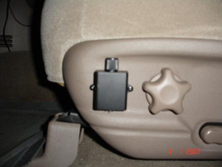

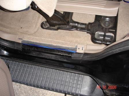

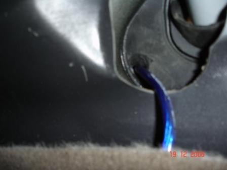

After my stress of having bought an amp off e-bay that was "new in box", which I later found to be broken, and after finding out the sub I found in my garage from my old ex was blown, I finally have my sub up and running. I wanted a stealth looking system so I am running off my stock HU. to save space due to my 3rd row and because I often put my seats down for storage, I went with the Infinity basslink. I read quite a few bad things about the basslinks auto on/off system but after finding out Infinity fixed the problem and now offer it as an option item, I bought it. It actually sounds really nice for what I was looking for. I sounds very tight, and if I want, it will shake my windows and tailgate (probably because of the recalled liftagate but thats a problem for another time.) I used a line out converter I bought from Ebay, ran the power lines through the rubber grommet used for the steering column, and ran down drivers side; RCA's and remote down the passenger side. The basslink comes with a level adjuster which I mounted on the drivers seat. All of the wires are hidden. the basslink is behind the second row. Thank you to toypaseo, and gsx220 for helping me solve my problems
