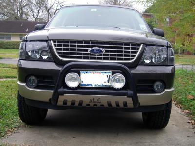

i have a weston ss bull bar on my 04 xlt with 6 inch kc lights the back of the lights hit the bumper so i put a small piece of flat stock on the mounting tabs then installed the lights on the flat stock
thats not good news, I was hoping the lights would not hit the bumper:( can I see a picture of what you did?
this is the only pic I was able to come up with, its so small though :-(
image.php
my lights dont even come close to my bumper. I probably have 2 inches of clearance maybe even more.
